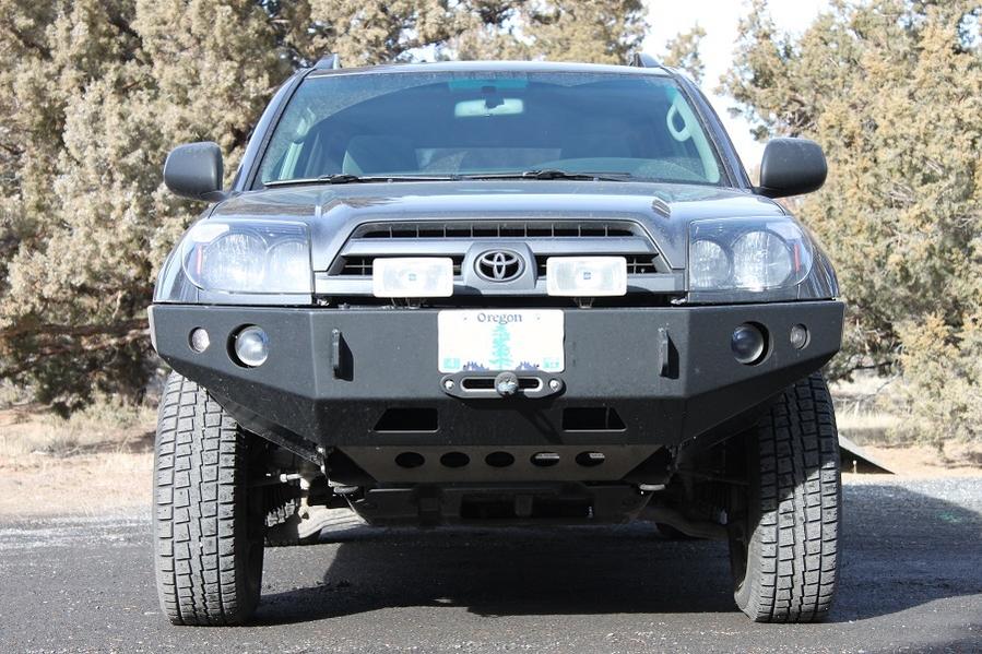

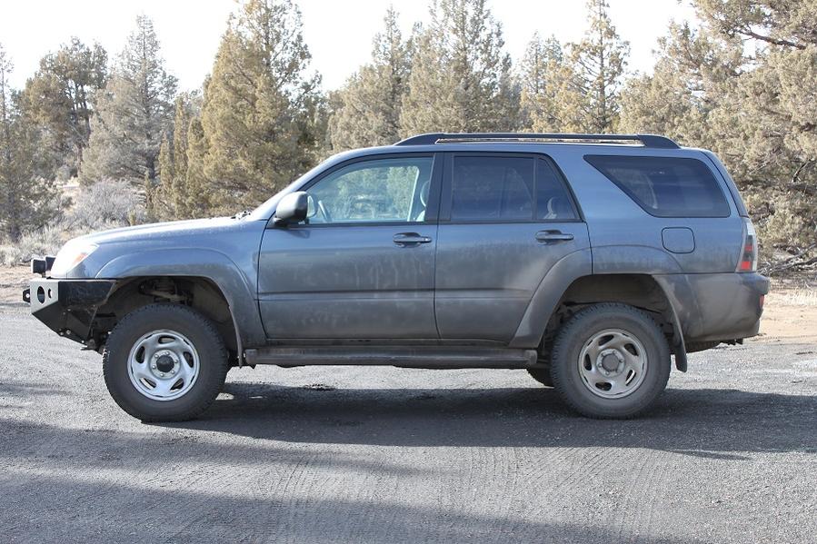

I run these old studded tires when we get ice. Like a week or 2 a year...maybe.
On old Sequoia/Tacoma steel wheels.
Just not super 'COOL' looking but they work when I need them.
