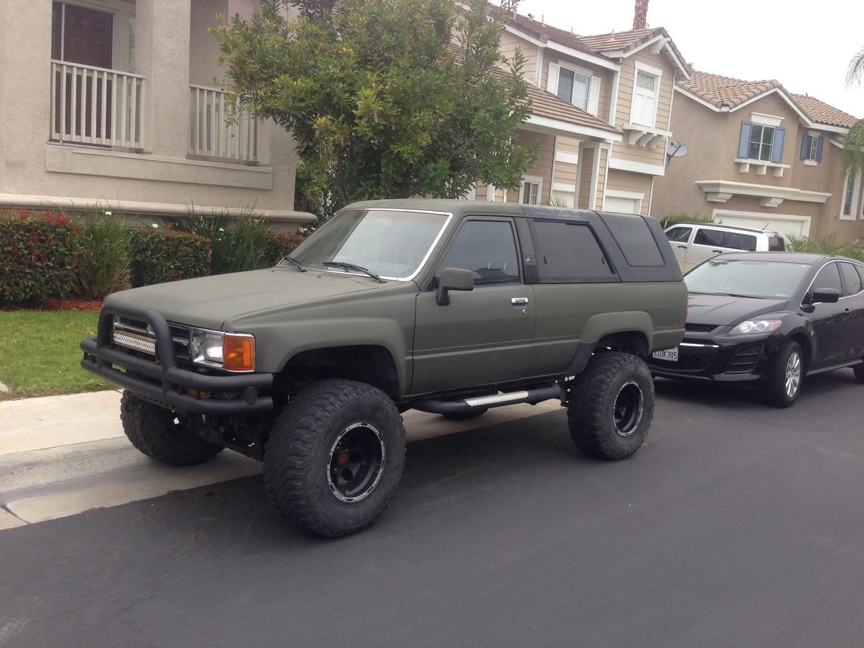

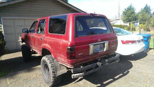

These were made Toyota specific. The front bumpers for p/u and t4r are the same but they made a different t4r rear. The front have a model year run that are 1st and 2nd gen specific but the rear is 84 to 95 interchangeable. The only place to find them now is Craigslist or junk yard. I ran these for years in the 80s and 90s. They are way better protection then stock. And look cool. If you want rock abuse worthy there are better options out there however. If just for a light duty trail rig there great. This is a pic of my bros that we just picked up from pickapart. [MENTION=98539]jugzuger[/MENTION]
