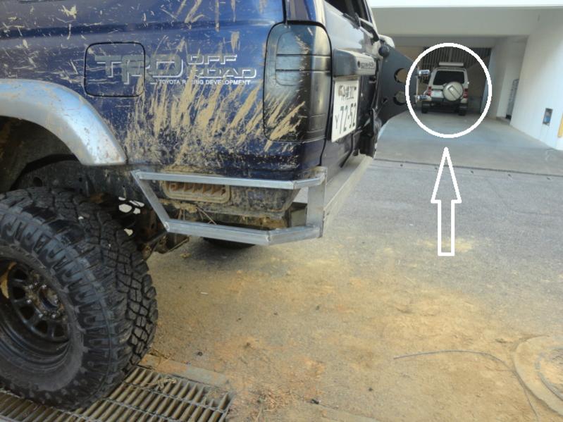

I ran out of time tonight. The wife had dinner ready and Japanese people don't take kindly to an angle grinder at 10 o'clock at night. They called town patrol on me! lol. Tomorrow I'm gonna finish up strengthening the sides, I'm going to box the rear part of the frame where the bumper mounts, add gussets to damn near every joint, and then throw some steel mesh over the sides. Also I'm gonna weld some light tabs on the rear crossmember right above the panhard bar facing the rear. That way they will be out of the way of rocks and other debris, but still provide light while I'm backing up at night. What do you guys think? Not bad for a day's worth of hard work and $100 worth of steel. It may not be "store bought quality", but hey, its strong, I'm getting practice with the welder, and most of all, I made this... :bravo:
Looks like it could be a 2nd Gen Pajero. Maybe a Nissan Patrol. The pic is too small to tell.
Sweet build, I like the rear bumper and tube doors, you don't see Hilux Surf builds here very often.
That would be correct. It is a Pajero Jr. No second gen though, they only have 1 generation.
and thanks man! Lots of fun building it. I love these trucks
