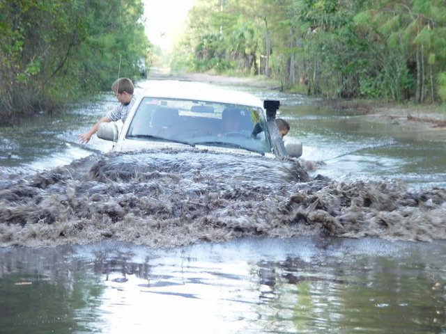

Wow. I'm IMPRESSED where you take your 4Runners (deep water!)!!!!!!

It's a given I had never heard of a snorkel before, but, it seems the sole purpose of the snorkel is to allow you to drive into deeper water (> about 3 feet) than the level of your air intake ... so ... the natural question that arises instantly is ... after installing the snorkel ... what do you do about protecting other components from water damage?
That is, after the snorkel, what do you do about protecting your ...
- Ignition system (e.g., distributor & coils & wires, if equipped)?
- MAF?
- Door seal integrity (and carpets if water seeps in)?
- Radiator fan?
- axle vents?
- transmission and transfer case vent?
- etc.

God, I could only imagine how much a kit like that would cost. it's best to just buy these water prep parts separately since most things you mentioned can be had at an autoparts store instock.
-Axle vents: diff breather mod.
-Door seals: if the car is moving with a decent rate through the water, it shouldn't be a problem. Unless you have tube doors, you should not be complaining about water in the cab.
-MAF: unless your intake tube is not sealed to water, this shouldn't be a problem.
Ignition wires: any well taken care of engine should have this taken care of already.
radiator fan: Becomes a propeller, WIN! jk. but it's just a bit more resistance for it, no biggie.
