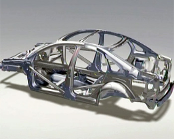

Unibody chassis were developed primarily because they are lighter weight and therefore allow for greater fuel efficiency. And I’m not just talking about trucks and SUV either. As recently as the 70’s, a lot of regular passenger cars were built on a body-on-frame chassis platform. Eventually, the people who design new vehicles realized that they could build their vehicles without a conventional frame and a body that bolted to it. So the unibody chassis was created. Look at the picture of a typical unibody chassis.
As you can see, there is no frame. The structure itself (including the door pillars and roof) becomes an integral part of the chassis. This is terrific for saving weight, but it’s not exactly ideal for strength or rigidity when it comes to torsional loads (typical in a variety of situations, including offroad driving). I realize that unibody structures have improved as the technology as evolved, but nobody can say with a straight face that a unibody chassis is anywhere near as durable or strong as body-on-frame. That’s why you don’t see full size pick-ups built on unibody chassis. Vehicles designed for hard work still utilize ladder frames, with bodies that bolt on to them. And when those vehicles have a fully boxed ladder frame, they are typically even stronger and built to handle even more abuse.
The Ridgeline isn’t really a truck. Sure, it has a bed like a truck, but it’s more of a car than anything else. I mean, seriously, the Ridgeline is about as much of a truck as the old Subaru Brat. Vehicles like that aren’t meant for any kind of serious work and people who own them know that or learn very quickly if they don’t.
When it comes to our 4Runners, they are absolutely body-on-frame. You can unbolt the body and remove it completely from the frame. I’m not sure what makes you think we have “a unit-body on frame vehicle”. That’s simply not true. Interestingly, the Jeep guys will tell you that their beloved Grand Cherokees (which have always been built on a unibody chassis) isn’t a typical unibody vehicle because it has lateral support rails built into it for greater strength. They like to call it “uniframe” and claim that it is stronger and more durable than a typical unibody chassis. There may be some truth to that, but at the same time everyone knows that their so-called “uniframe” is a poor substitute for a true ladder frame.
