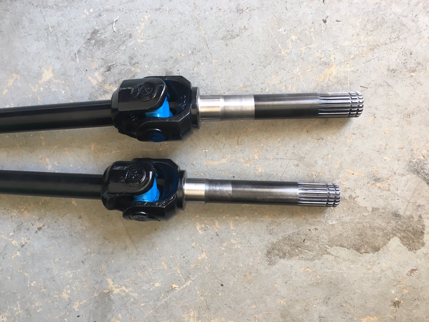

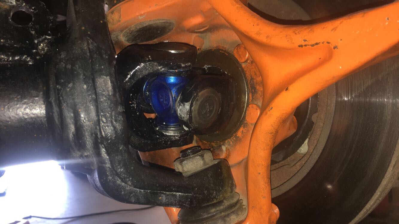

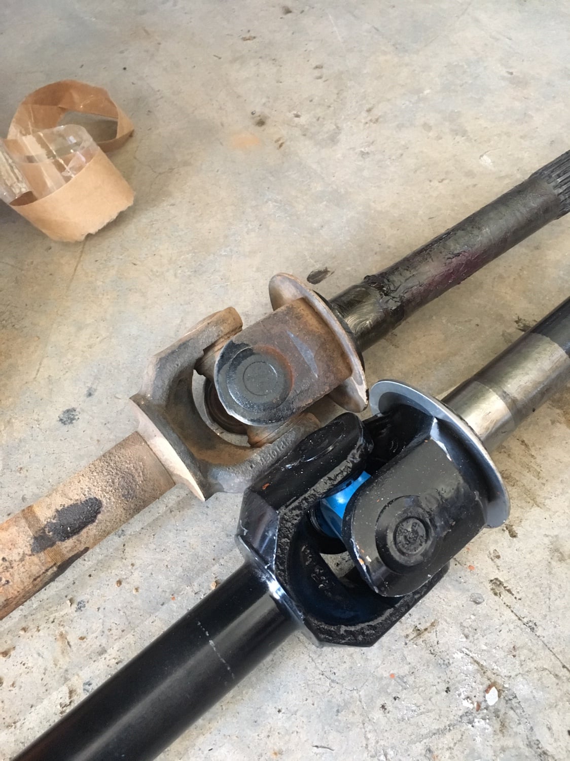

New HD axle shafts and ujoint

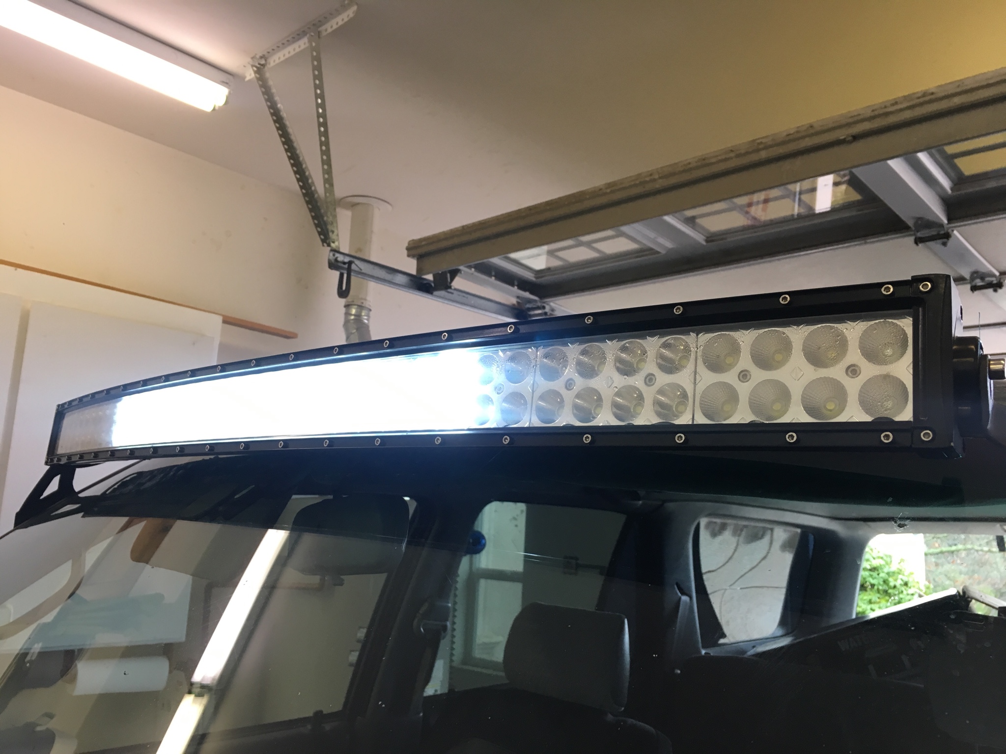

replaced this light bar with new one and sealed it up to stop moisture from coming in

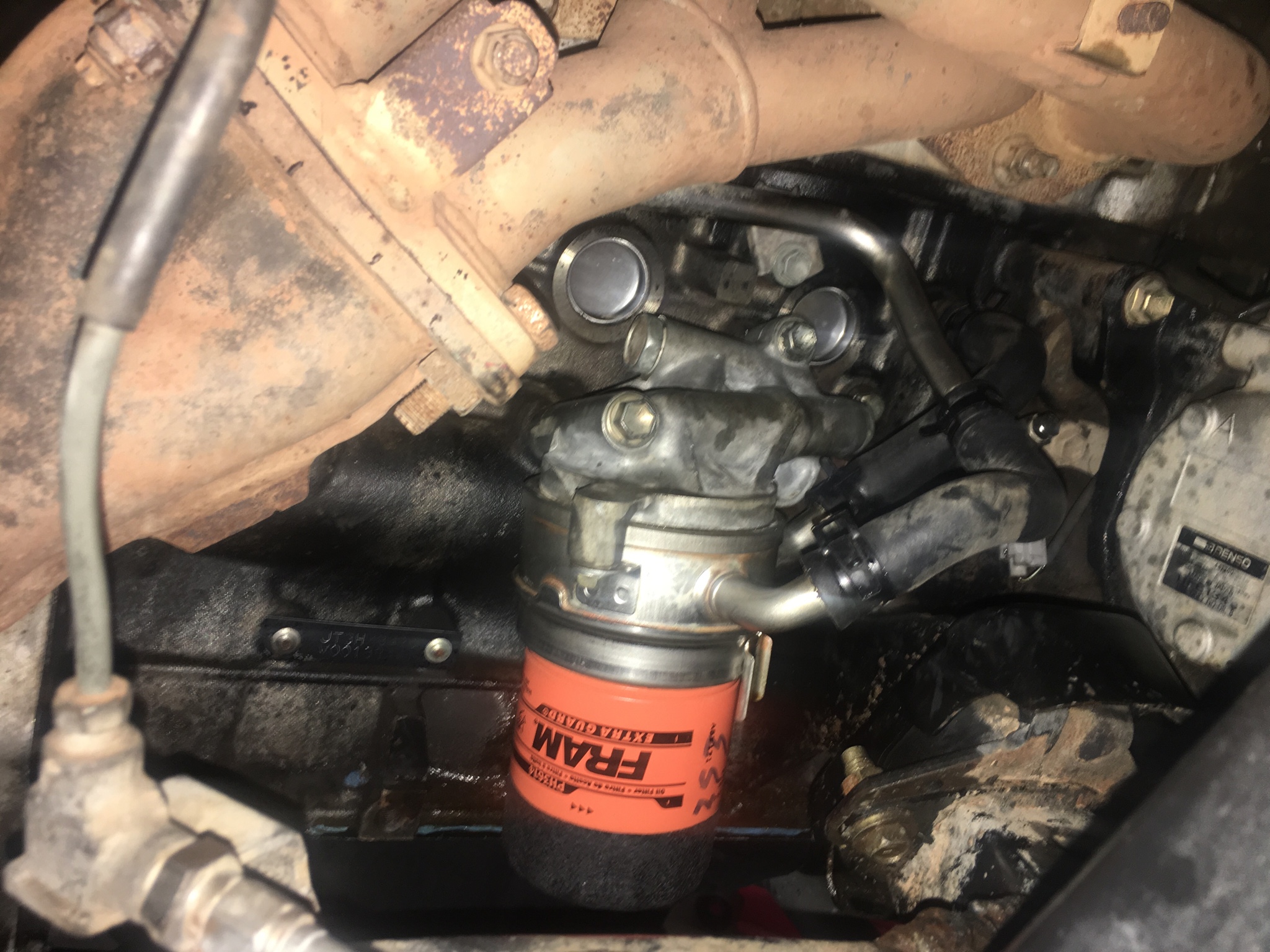

replaced oil filter housing seals

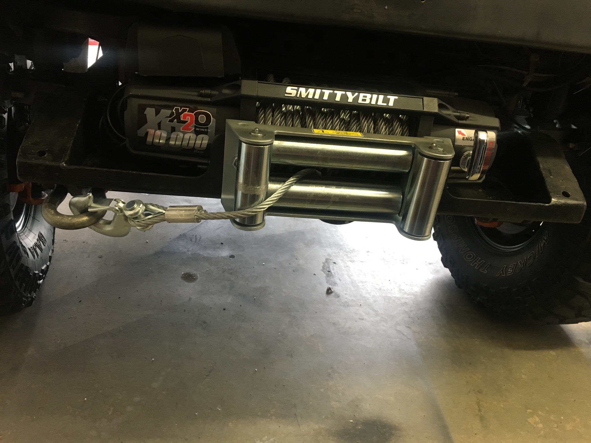

New Smittybilt 10k waterproof wireless winch (had to cut 20ft off cable because there was so much cable that unless wound up perfectly, it would bunch up and hit the rails under normal use)

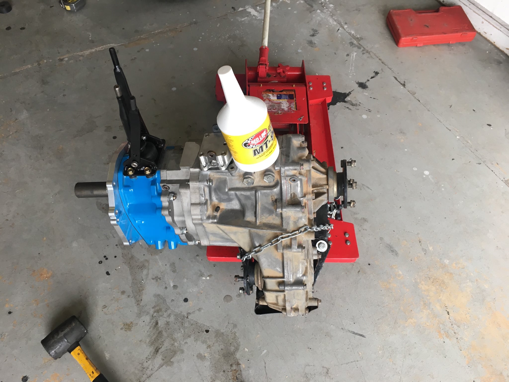

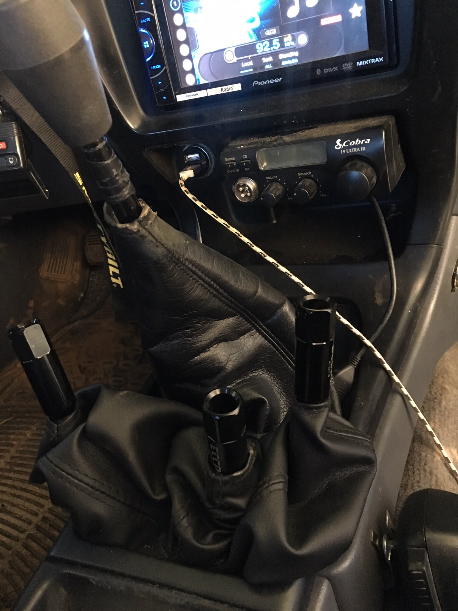

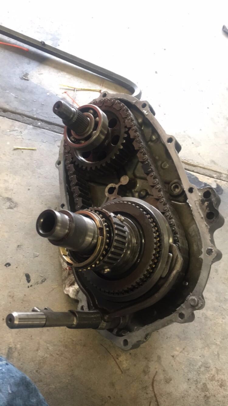

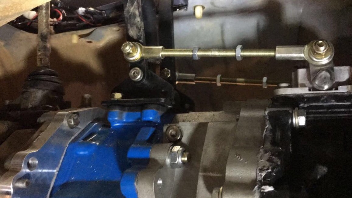

Installing dual cases with a kit from trail gear and triple sticks from radesigns

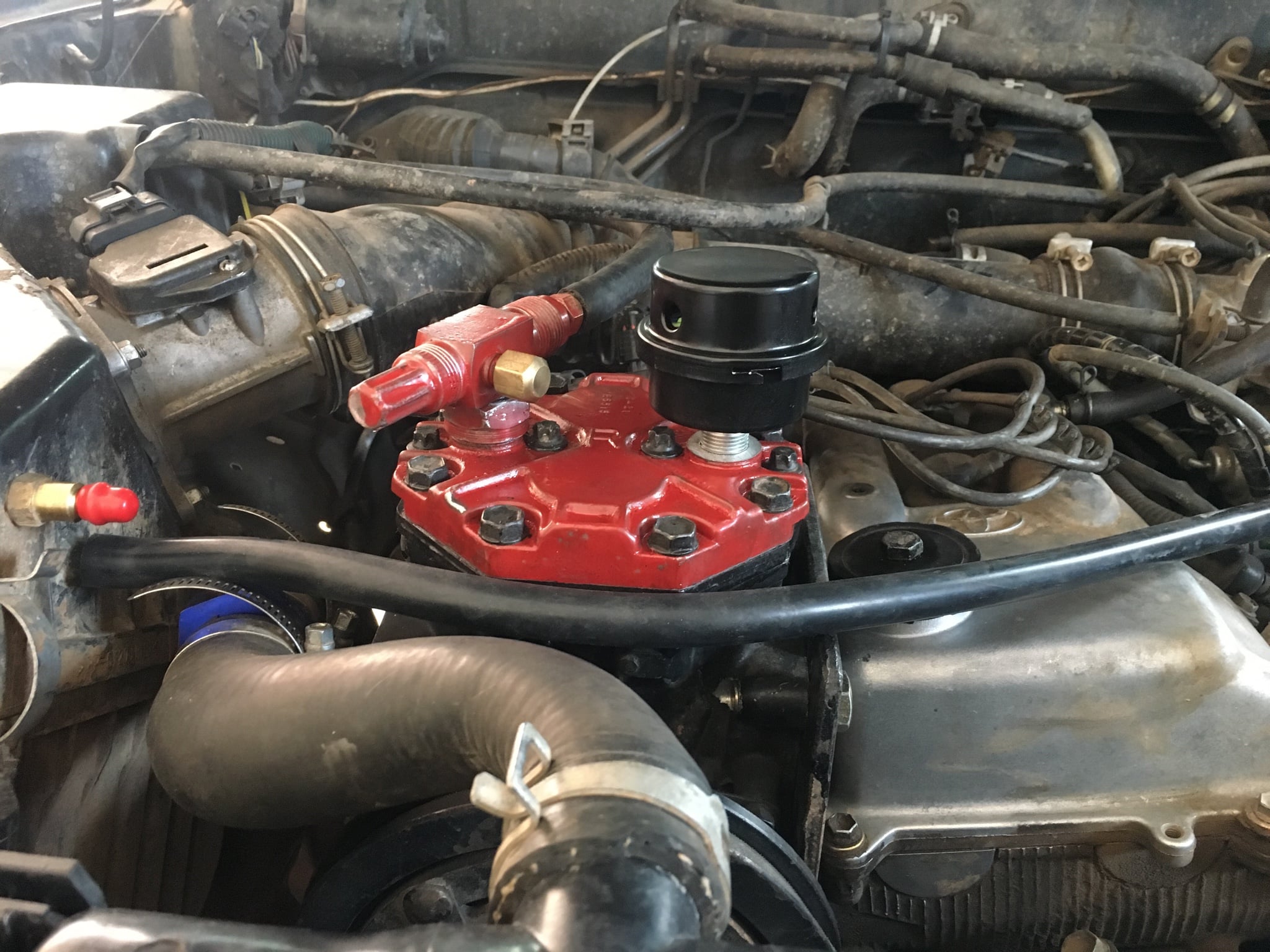

Also installed larger check valve and lines on the the York compressor and filter

Today I spent about 6 hours modifying the transfer case for the triple sticks so it will allow 2wd and 4wd shifting while in low range

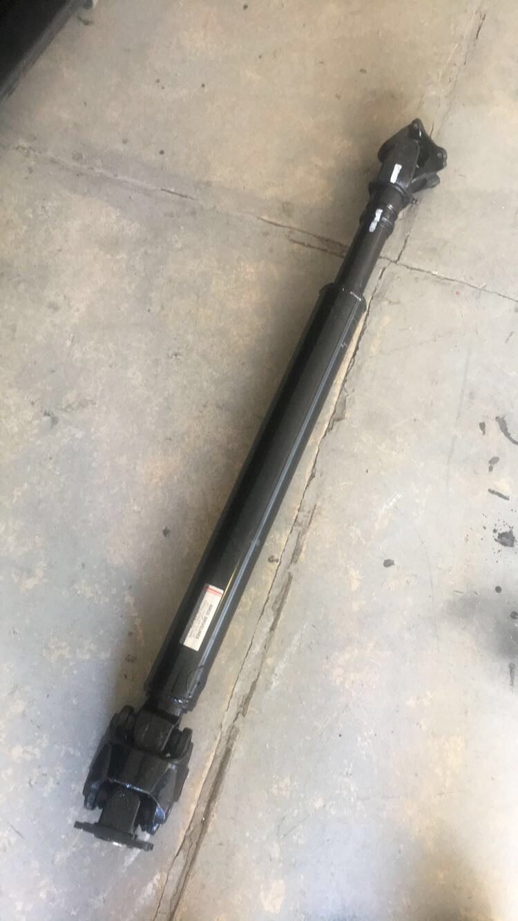

Got the dual transfer cases in and new HD drive shafts made
Used trail gears dual case crossmember. It bolted to the single case cm with out a problem.

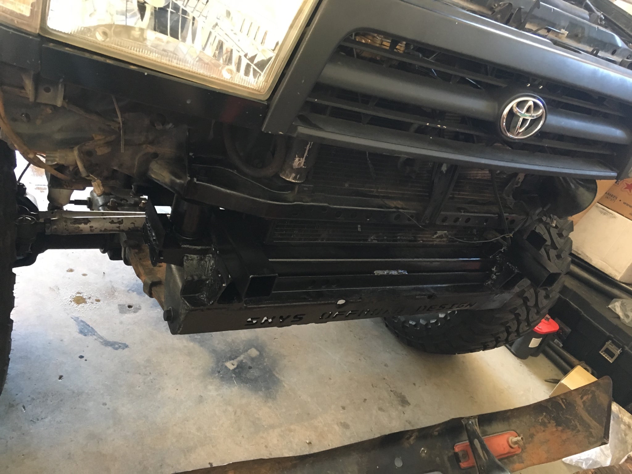

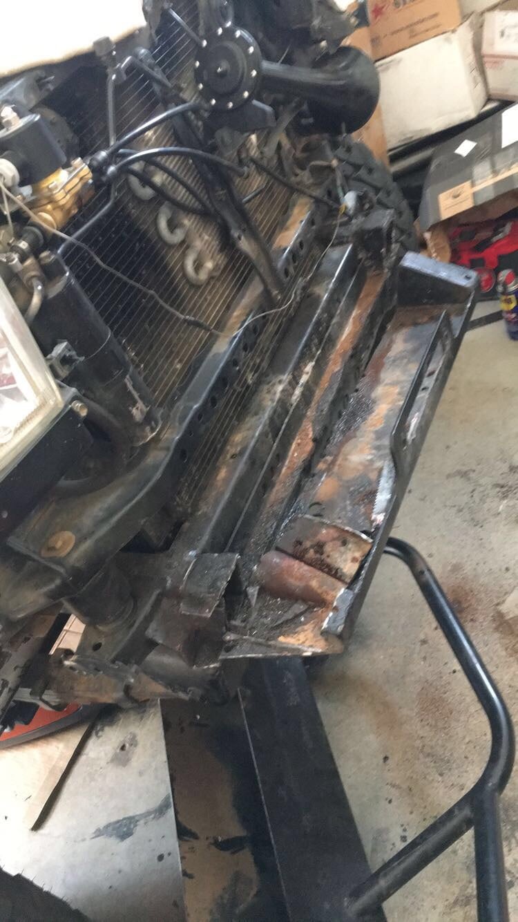

Hacked off my winch mount today
Welded some metal/ gussets to the top of the frame to Accommodate for the 2in body lift
Still a few things to do but it came out good.

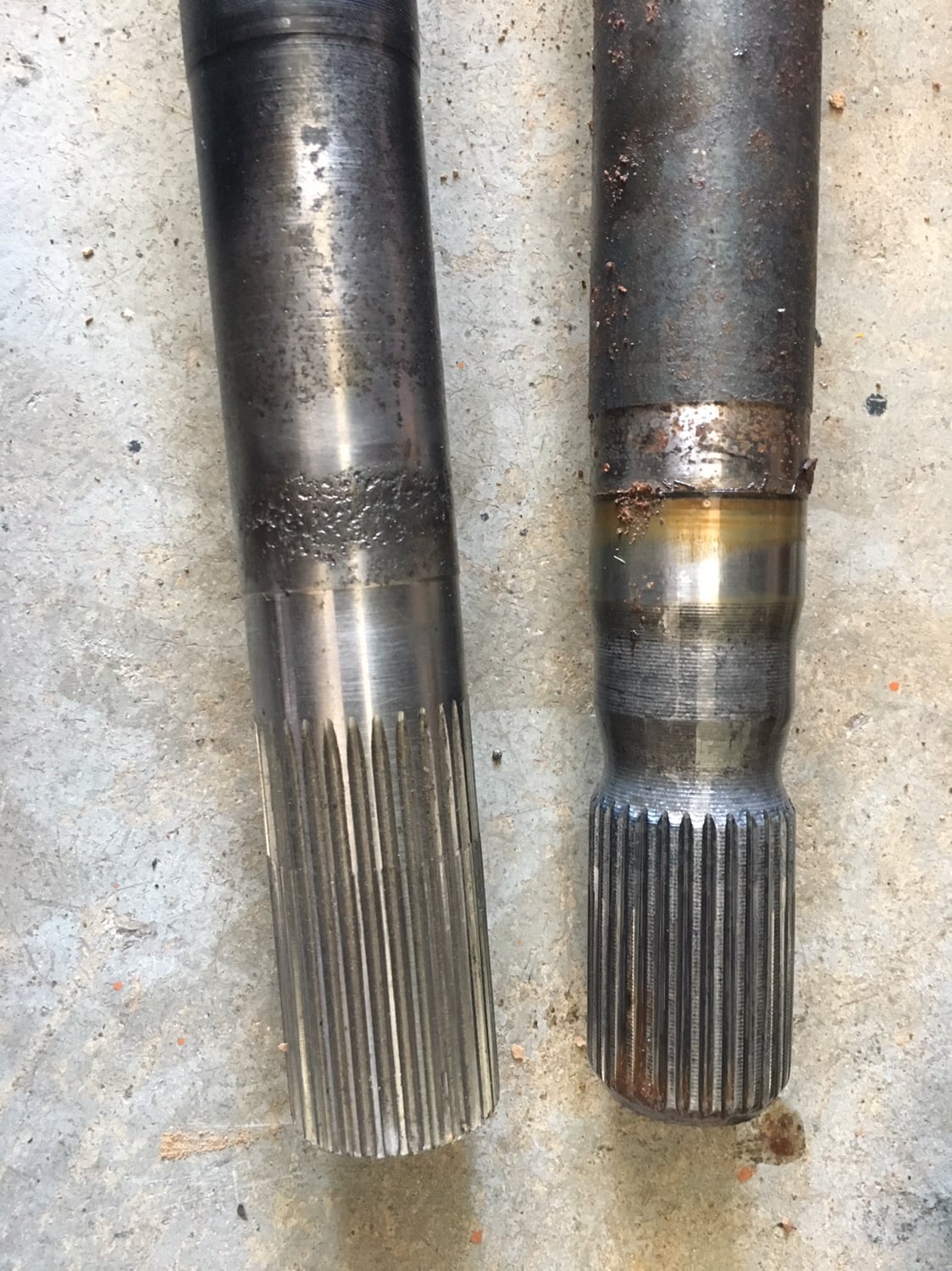

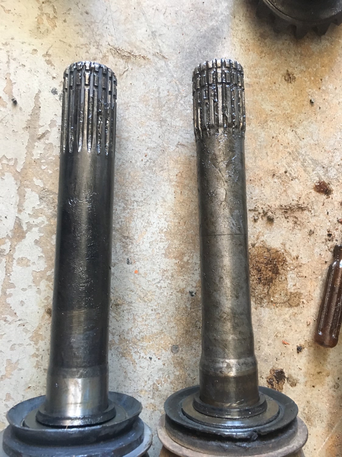

Assembled custome d44 widetrac chromo Dutchman axle shafts today.
You can see the thickness difference on the ears and shaft

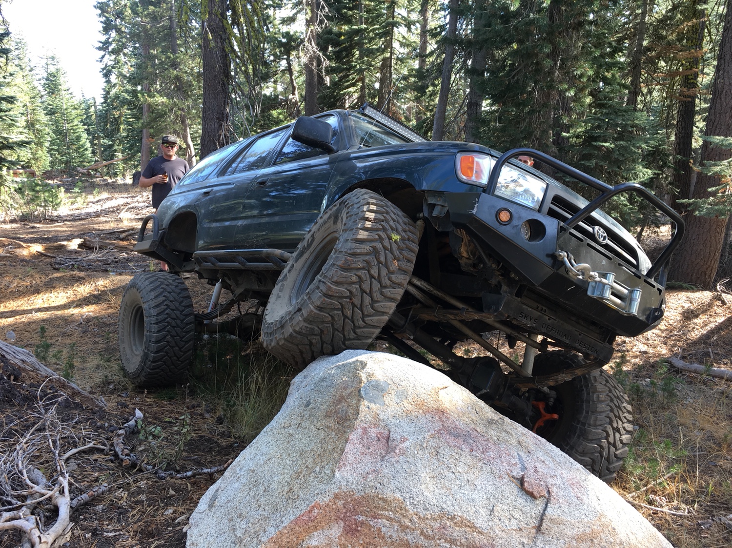

First rubicon trip with the dual cases went great. Made such a big difference. The low range made the entire trail so easy, I didn't need to ride the clutch all the time, hill/ ledge descent was a dream.
I did notice the first transfer case occasionally did pop out of low when going down steep hills.

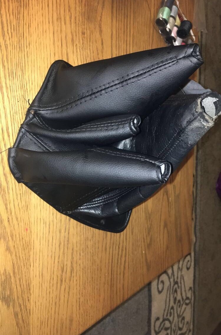

Ordered hd shift spring and might trim shift boot so nothing hits under load.
