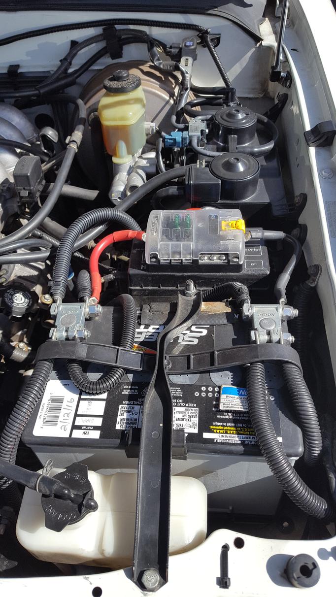

I have that brand for the 03 4runner. What accessories do you have plugged to it ie fog lights, light bar etc.?
Sent from my SM-G930P using Tapatalk
(1) set LED lights, (1) set of Hella 500 foglights, and a winch. That's it, no big stereo system. And I also did the Big 3 upgrade as well and plan on upgrading the alternator when this one takes a dump.
