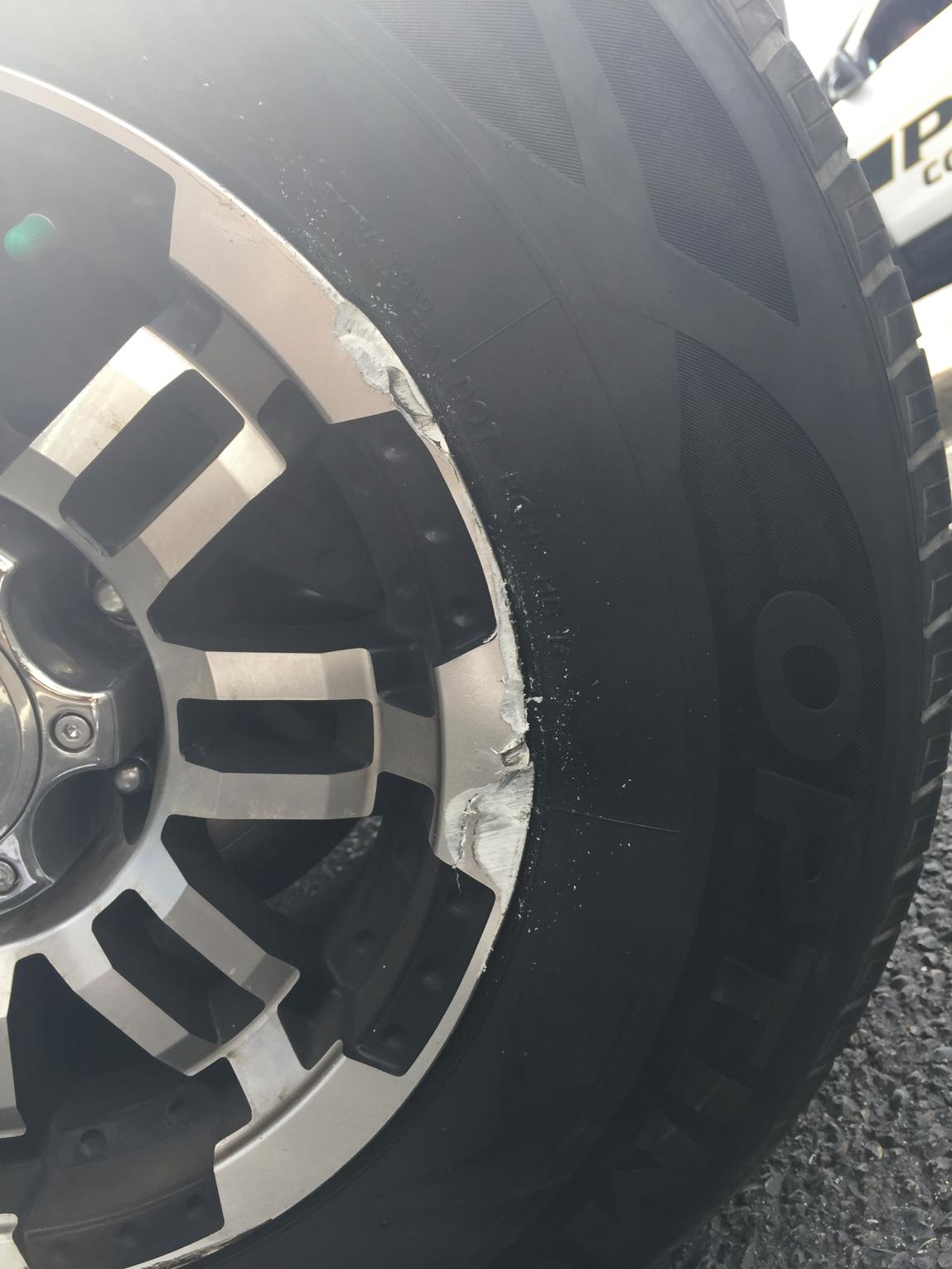

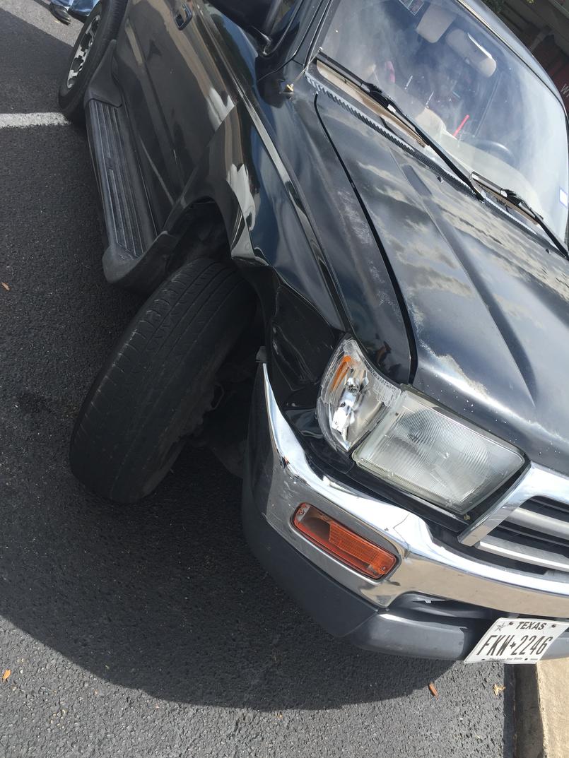

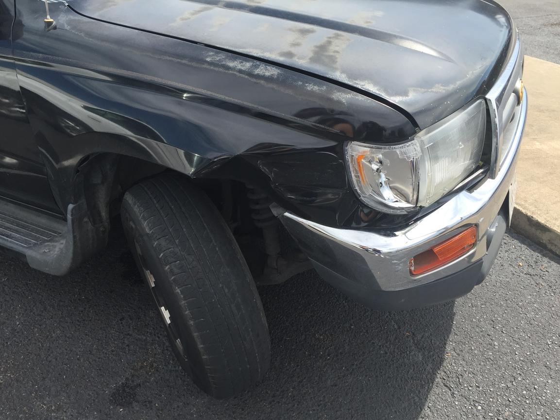

An old man decided to pull out from a shopping center into the main street and into my lane.. I couldn't prevent from hitting him. Bumper, fender, grill, rim is cracked, lights are all trashed and my alignment is way off now.. Do you all think this may total my vehicle??

doesn't appear to be much damage, mostly cosmetic but unfortunetly old vehicles don't have much 'head' room for $ cost and get classified as "totaled" pretty quick. I used to say no to something like this but now this is 50/50 to me. On the otherhand, perhaps you can buy it and fix yourself (or thru your mechanics). In texas law requires totalled vehicled be made available to the previous owner for 15% of value. Luck. :cowboy:
Looks like the alignment was already off by the way that tire is worn.
It's fixable.

Alignment was off last year and fixed it around December 2015 along with inner/outter tie rods.. I got it fixed and replaced the driver tire cuz wires were showing the same day.. But i never replaced the passenger tire cuz the driver tire was the only one showing wear and tear. Passenger tire has been wearing out slowly but surly but my alignment has been corrected since December 2015, so not sure what else it could be if the alignment was fine this whole time?????????????????????

Camber and/or Toe was still off. Best way to know for sure if alignment wasn't done correctly is to look at the wear on your new tire.
Could also be that your front suspension (coils/shocks) are worn, causing the front end to remain in a more "compressed" state, which keeps your camber out of whack and wears out the inner portion of the tire.

Worn bushing, bad ball joint, sloppy tie rods, worns or leaking steering rack, lower and upper control arms are likely toasted from age, uv, and heat.
Theres alot more to a front end than an alignment. You can put worn parts straight, but the tires will still wear funny.
I cringe when i see people replace front end components one a time, and one side at a time, usually waste a tire each time. You'll find this person at the tire store at least every 3-6months. Of course, paycheck depending.
It has been my experience that no matter how experienced your aligment shop, they cant fix worn, used up parts. No front end component last forever, and it can be dead straight, but with worn a arm bushings it will still wear.
