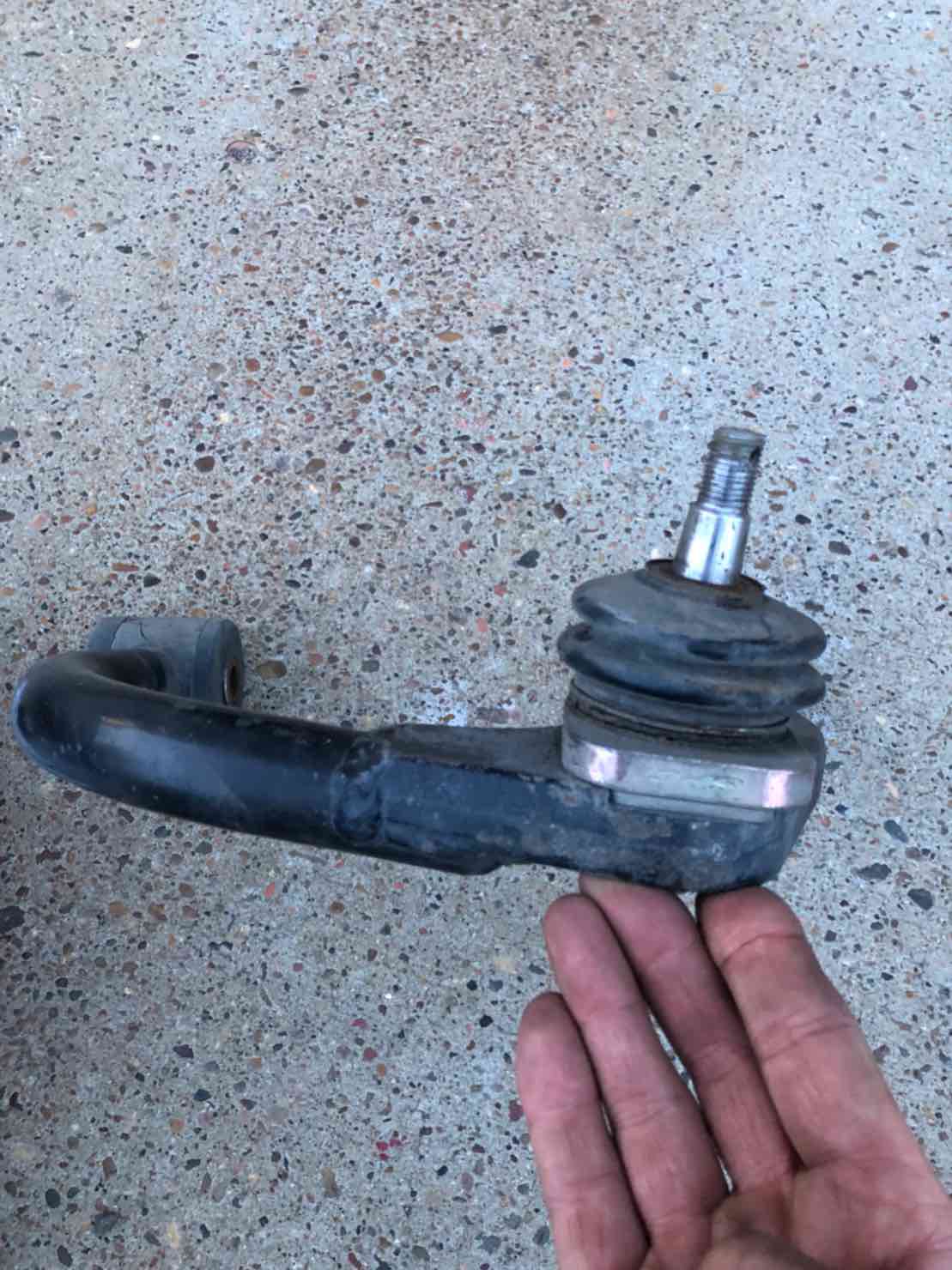

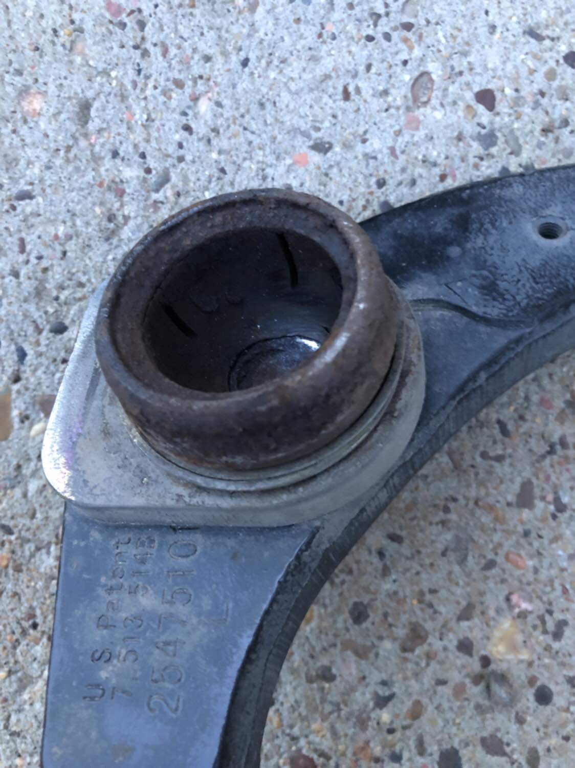

Do the SPC uniballs come pregreased? Looking at the pics, it looks like there's been no grease in there at all.. It's just... Rusted...
That's not a uniball, it's a ball joint. They do come pre greased from SPC just like every other ball joint in the world. Think of it this way. Our OEM arms and every other suspension component can't be greased, no zerks. They still last 150K-200K right? There's no excuse for ball joint failure in 50K-60K. The reputation of these arms speaks for itself.
Don't know why I said uniball. but anyways...
Is the amount of grease packed in the balljoint from SPC adequate enough to be ran for many miles? My assumption is that the balljoints aren't packed with an adequate amount of grease/if at all, and expect the user to pack the balljoints properly upon installation. It's even in their instructions to grease the balljoint during installation. And the fact the OP didn't even service his balljoints means they were running dry for some amount of time. Looking at the picture, that ball looks rusted... Badly...
It's true that OEM components that are sealed can't be greased, but they are/should be packed with the right amount of grease.
By no means am I defending SPC, as I have read countless threads about them failing, but it'd be interesting to know if this was indeed another failure caused by the part itself, or a mixture of the part and owner not doing maintenance.
Totally agree. I don’t have aftermarket arms yet, so I read everything I can about the different brands, good and bad. The one basic thing, regardless of brand, is that all moving components NEED lubrication! I’ve dealt with aftermarket, poorly designed seals on other project cars, and the solution is always to check them periodically, and grease as needed. The pics show that those were likely NEVER greased, other than maybe the initial grease from the factory, and if the boots don’t seal well, that would get washed out in a year, or 2 with rain, salt, etc. Not saying SPC arms aren’t low quality, but some onus lies with the OP inmo...

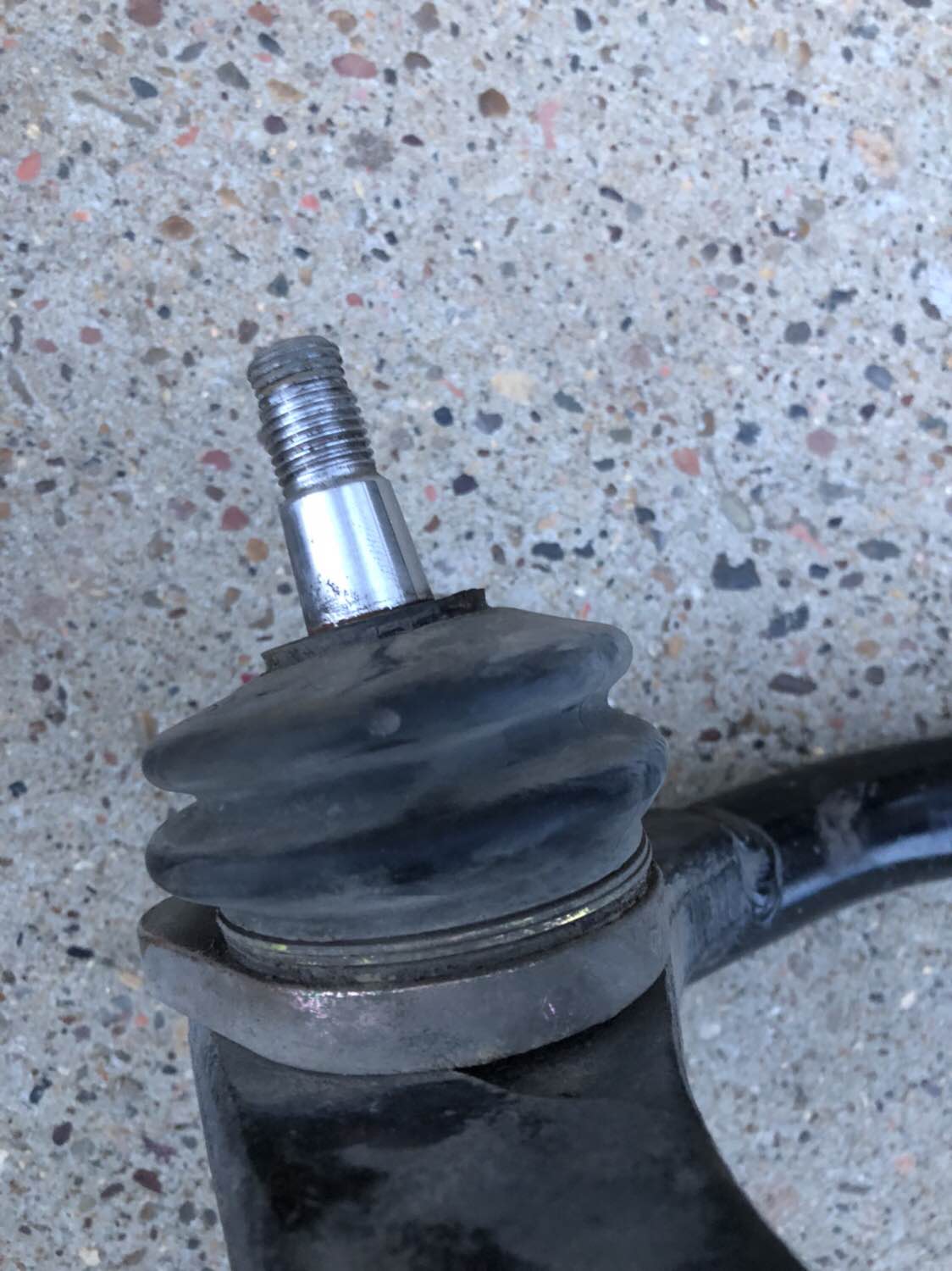

Here are the driver side (bad) and passenger (intact). Looking at it, there is no spot to grease them
