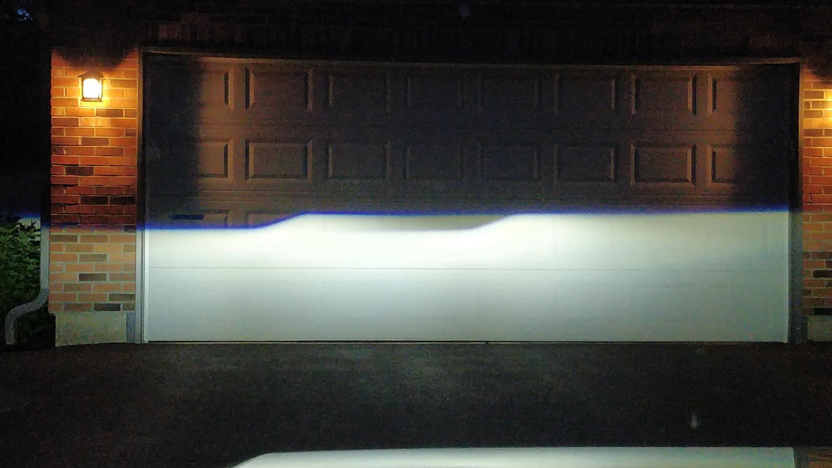

Like almost everyone I hated the factory halogens and was waiting a few years to see when Toyota would finally update the headlights on the 4runners. I couldn't wait any longer. I just finished a morimoto MLED 2.0 bi-LED retrofit in the factory headlights. I also installed the Toyota oem LED fog lights. They are amazing compared to stock and were definitely worth the upgrade. Of course the factory option was just announced after me finishing these. I can't see the new LED oem headlights being any better than the morimotos so I will keep them till the next major headlight technology upgrade. I attached a photo of just the low beams on, amazing cutoff and lots of even light. Definitely worth the upgrade. In my opinion they are better than any plug and play HID kit and rival any HID projector.

Looks really good. Do you know what the spread angle is on these? I think the IS projectors I'm working with are 160 degrees.

Not sure on the spread angle but there's a lot of stats listed online if you search. The side illumination is much better than stock but that can also be from them just being brighter in general. the picture I posted earlier in this thread was from 25 ft away from the garage door when I was leveling it. I can try and get more further in the distance pictures when I get some free time. Activating the fogs adds additional lighting on the sides as well and the high beams are great.
