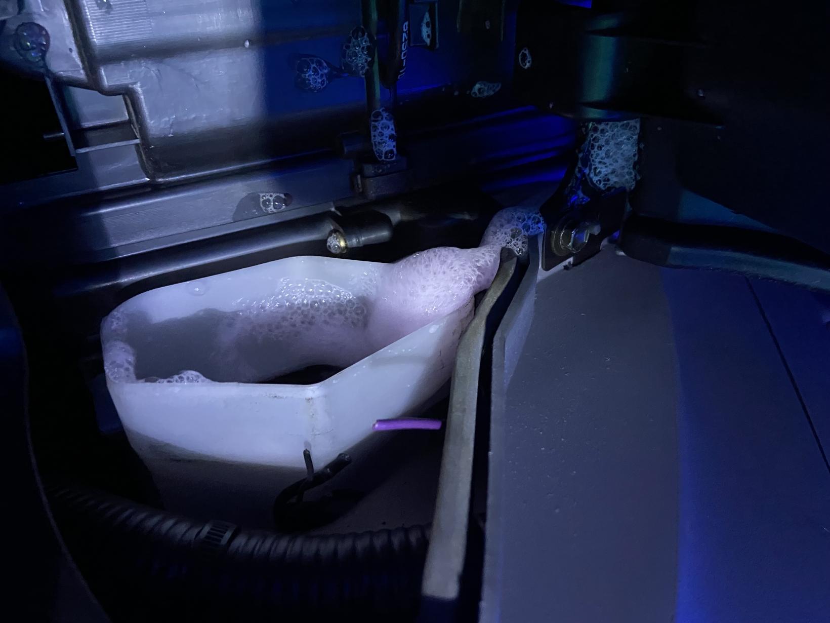

Here is where the soapy water is coming from.

Where exactly is that opening. I took the wipers and cowl off and ran volumes of water and both sides drained water behind the front door hinge area. It looks fine. I need to find the fresh sir inlet hole.
Soapy water makes form and will rise above the fresh air intake located below the wiper cowl. Those are now been pulled in by the fan and sent all over the duck lines. Next time when you go for a car wash, have the interior circulation mode on.
Your car has no problem.
The cowl is the plastic panel mounted horizontal below the wiper arms and between windshield and hood. The fresh air intake is located under the cowl towards the passenger side right above the blower motor. It is a raised opening so if you want to see it, remove the cowl, then flash a light from the driver side towards the passenger side.
I removed the cowl and wipers. I see the trough running from the passenger side to the drivers side. Where you are talking about is under that raised portion on the passenger side. It’s like a box/tunnel that is covering the trough. I can’t see in it but what you say makes sense.
Thanks!
Inside that tunnel, you should see a raised rectangular/square metal opening. This is one of the famous mouse nesting ground when vehicle is parked for a prolonged periods. When fresh air door is open, debris will fall into the blower motor!
That makes sense. The suds are higher than the water so they run in and down into the blower motor. I understand. I want to thank you as you are the first person on any forum to explain this to me. Thanks!
