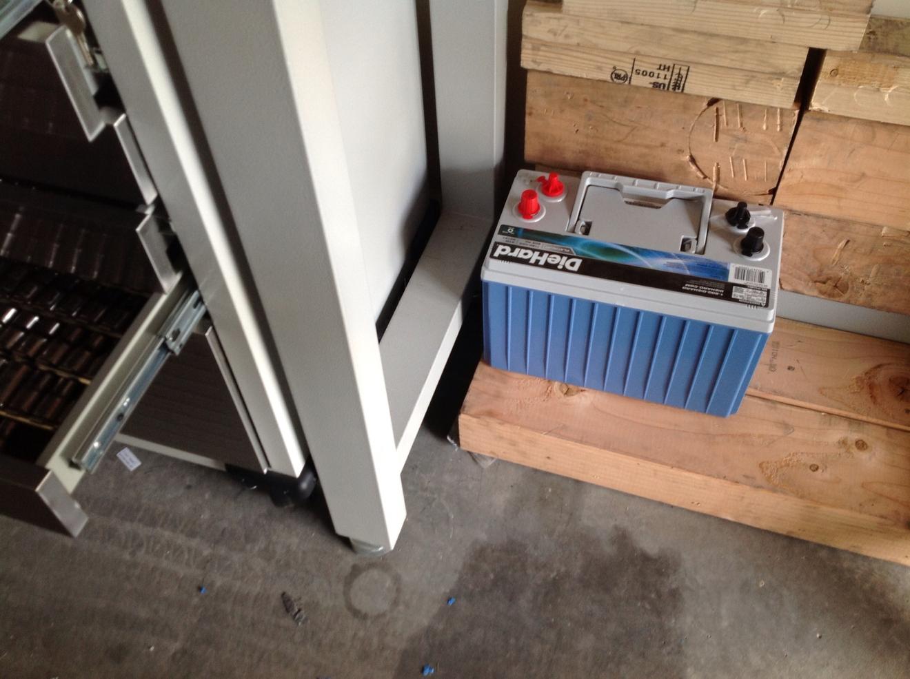

This battery is collecting a lot of dust.... Talk to the wifey and make this tray happen.
Since we're all showing off here, this guy's been collecting dust too and waiting for a passenger side battery tray to fit the Group 35, hint hint.

Showing mine off waiting for group 31 main tray
