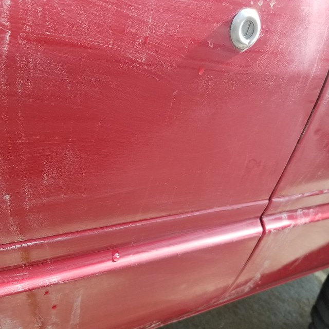

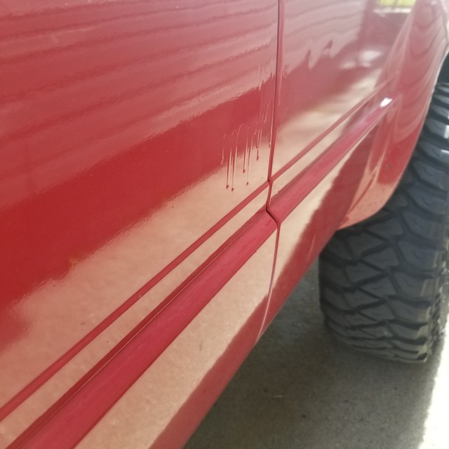

The truck came with some paint runs so i wet sanded them yesterday and will polish today, pending weather.
Before sanding:
After wet sanding:

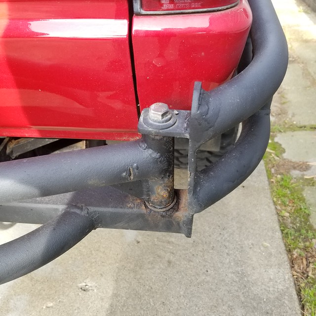

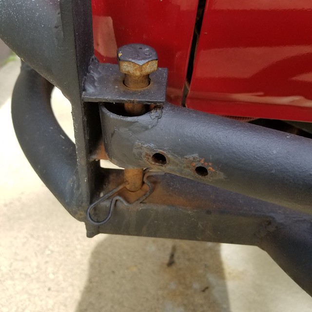

The truck came with homemade bumpers that make quite the noise as the latching side has no bushings:
I measured and ordered urethane step bushings which will hopefully stop the squeeking in the meantime until i can lose the body lift and get replacement bumpers.

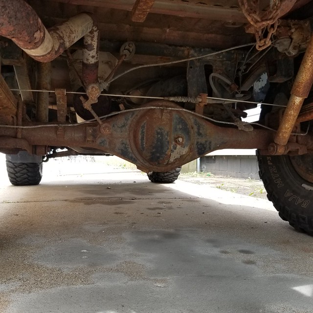

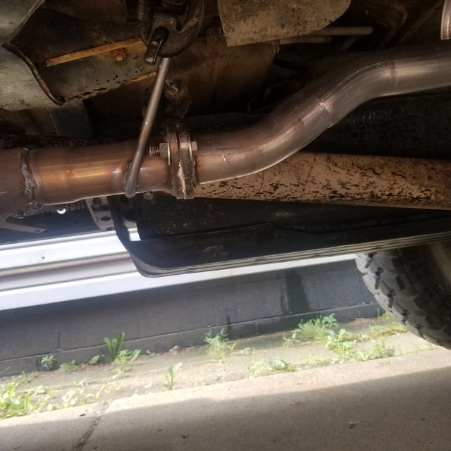

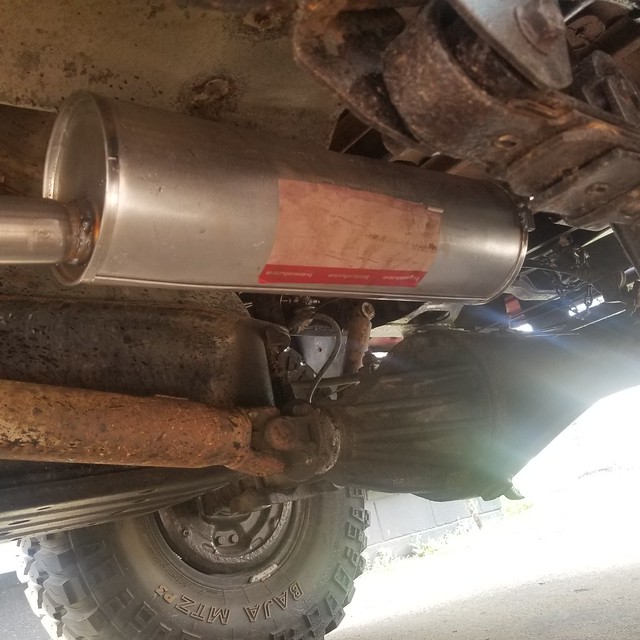

The underside needs some love as well:
I spent time under the truck yesterday with a wire attachment on a drill to remove the loose stuff, and have corroseal on the way to spray the underside.

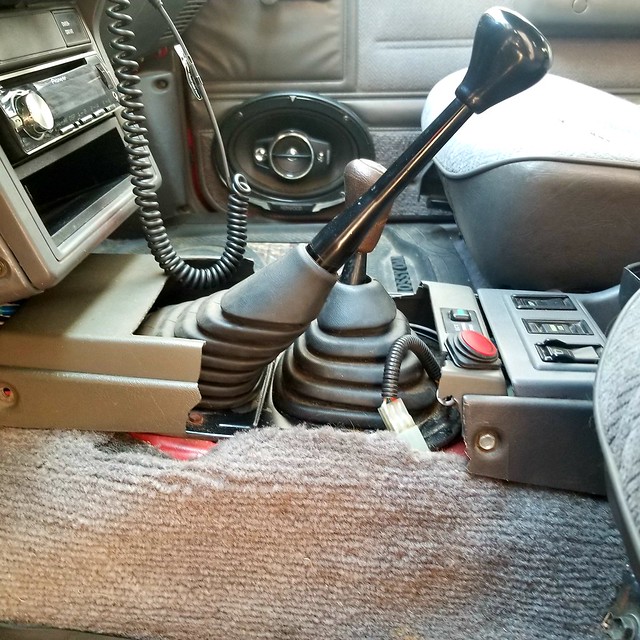

I took care of a few other small things yesterday like adding the missing clutch pedal pad, dome light cover, and removed some stickers from the glove box. I have a replacement shifter bezel to install to replace the broken piece inside. I also have a switch panel for beneath the radio so i can relocate the bumper light switch and have space for future enhancements.

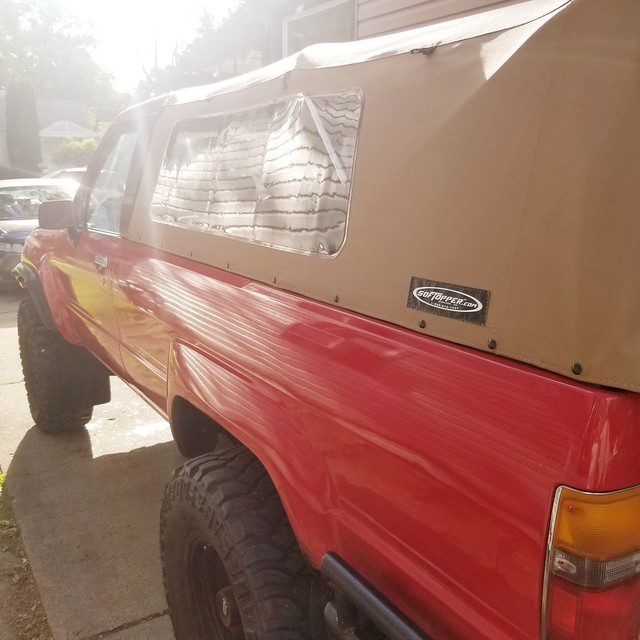

Finally, a tan soft top from Softtopper is on the way and should arrive this week. Looking forward to getting that installed.

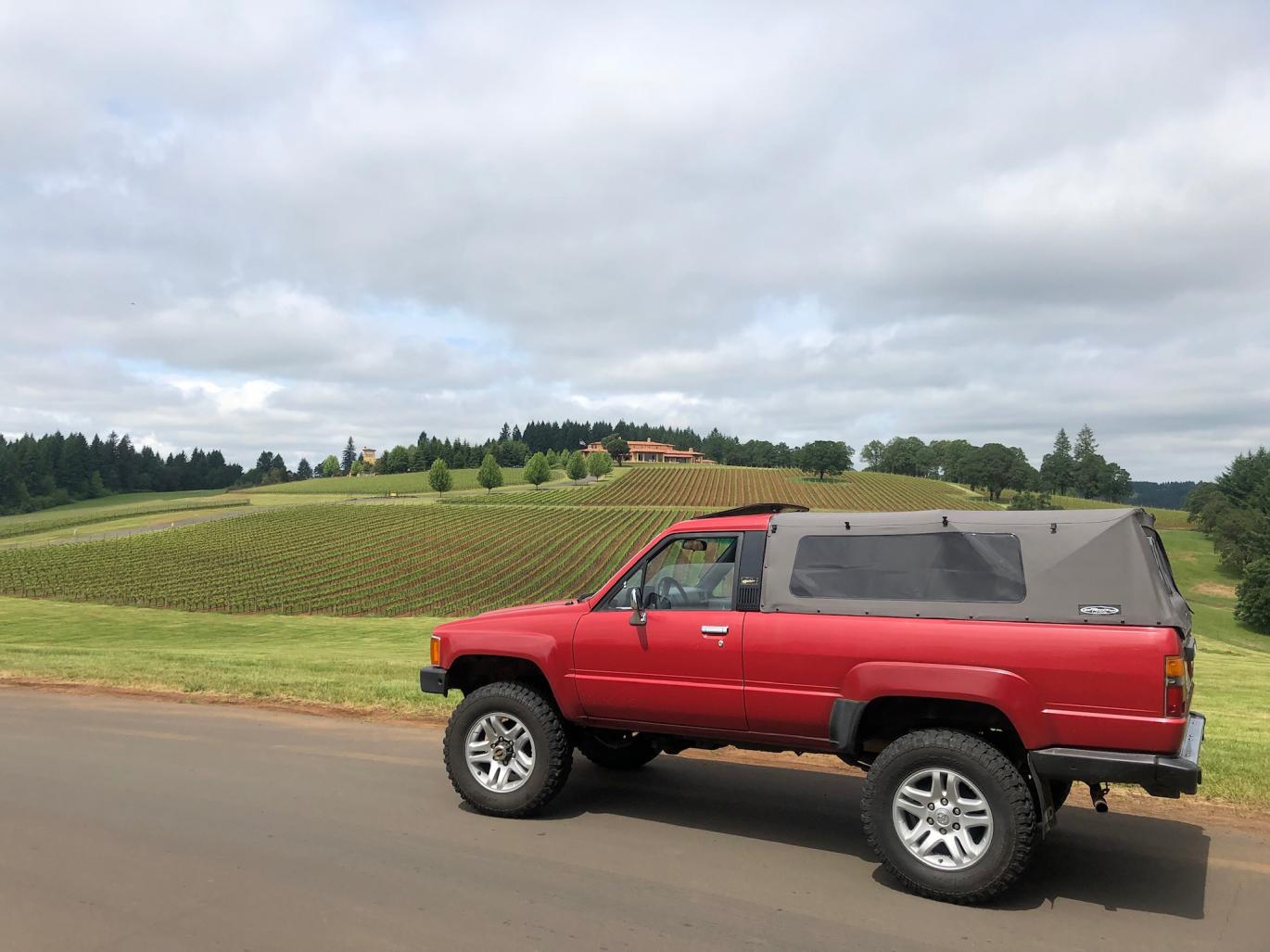

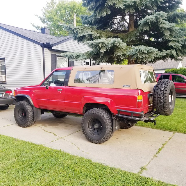

Congrats on the new rig! You will love the Softopper. I just installed a gray one on my red ‘89 4Runner. I like the tan color better, but have a gray interior so went gray. At first I was unsure, but it’s grown on me. Yours is the tan interior?
I have OME suspension in mine and like the ride. 31s look too small in my opinion...

Thanks for the reply. I do like the 33's so maybe will look into OME. I believe that is what the Rover had installed originally. My interior is actually gray, but i LOVE the tan top so I will deal with a mismatch. SO far I love the truck. It is faster, more efficient, less expensive for trim and other random parts, and has yet to leave me stranded :lmao:

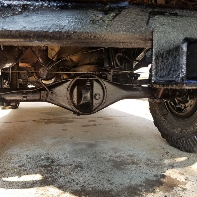

I spent some time under the truck yesterday treating the underside of the truck with Corroseal. So far it looks much better. I wasn't going for a restoration or show quality, just knocking off the loose scale and coating.

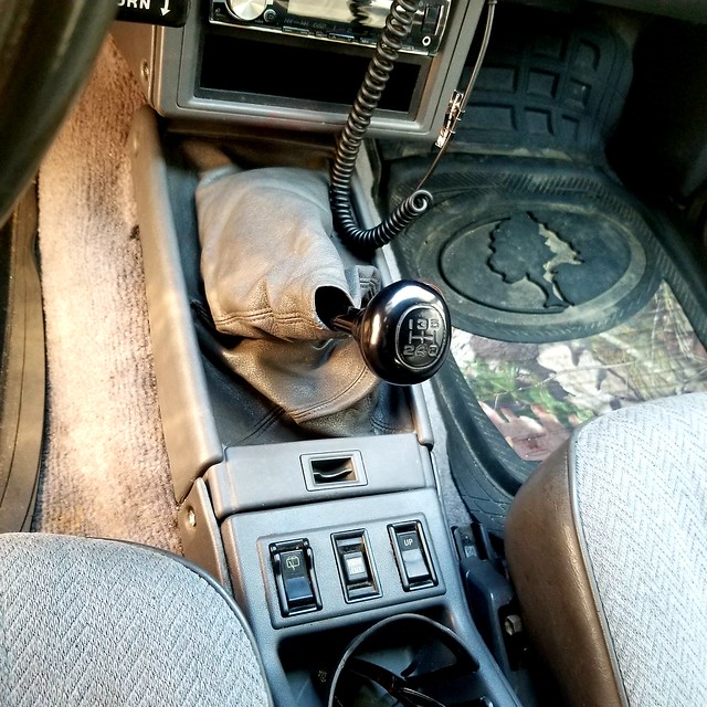

I also pulled and replaced the broken shifter trim. I am told the truck was originally an automatic (and black), so this may hvae been original auto trim. Unsure. I also moved the big red switch which controls the bumper lights. I have a paranoid fabrication switch panel to install beneath the head unit.
Who did such a terrible job on the paint runs :O?
PO I believe. I will keep wet sanding and polishing to hopefully hide the majority of them but i keep finding more. The truck will get stripes so I am not too worried about the paint.

The 4Runner came from California a few years ago so is mostly clean, but has some light rust underneath ...
Came from California and light rust? must have been the part of CA underwater.
Sorry but that is a lot of rust IMO.
Good luck with it. Glad you are bring it back to life. These things can be addicting
Ha maybe I should have worded that differently... light rust for a Toyota that has been in Michigan for a few years...

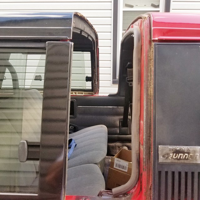

Bending the front piece was not hard, but if you bought a us3d one that wasn’t originally bent well could certainly add to the difficulty. With new, you should have an easy time with it. I was going to install mine on a road trip this Memorial Day weekend, but wisely got it done before we left. Having a big table to work on was a help.

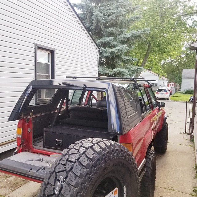

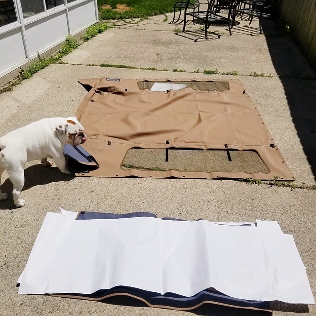

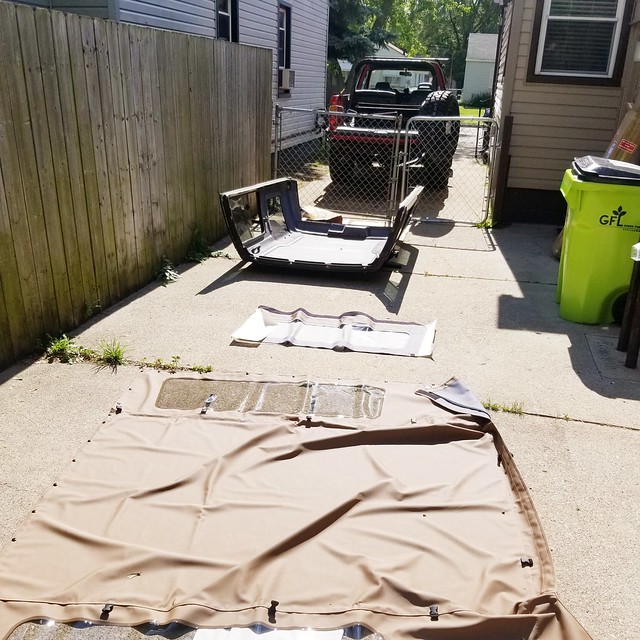

I made quite a bit of progress over the weekend. The SoftTopper arrived, so I let it sit in the sun to help ease installation for a while.

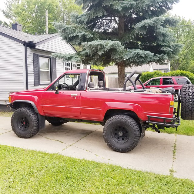

I then worked on taking the top off for the first time. It was pretty easy and light compared to my International Scout.

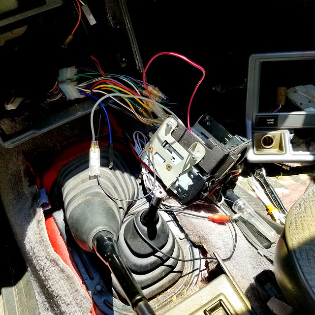

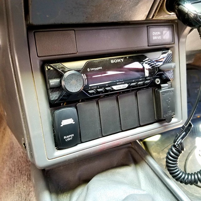

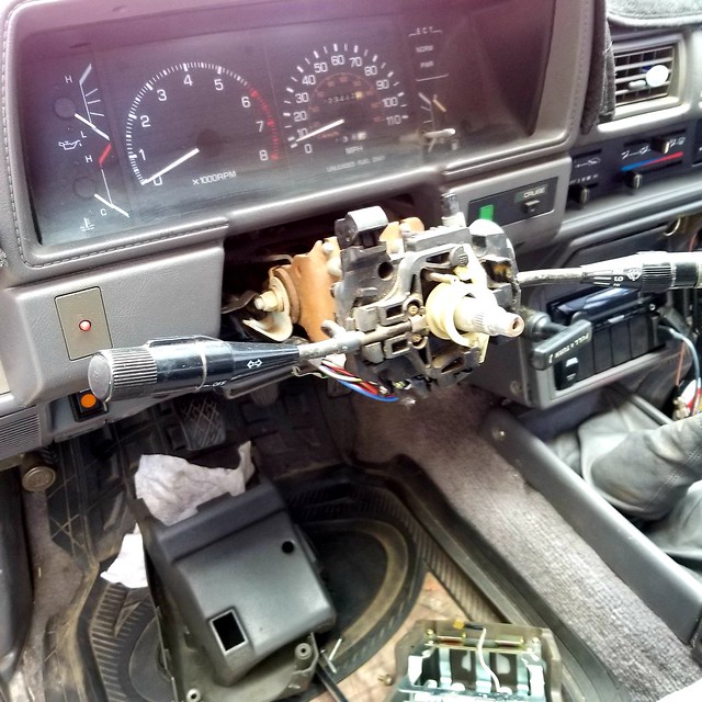

I then turned my attention back to the interior. The truck came with broken trim which I already replaced, but the peripheral lighting was wired to a switch attached the the panel which I replaced. I had ordered a switch panel from Paranoid fabrications as well as a new head unit for bluetooth.
Before:
During:
Currently:

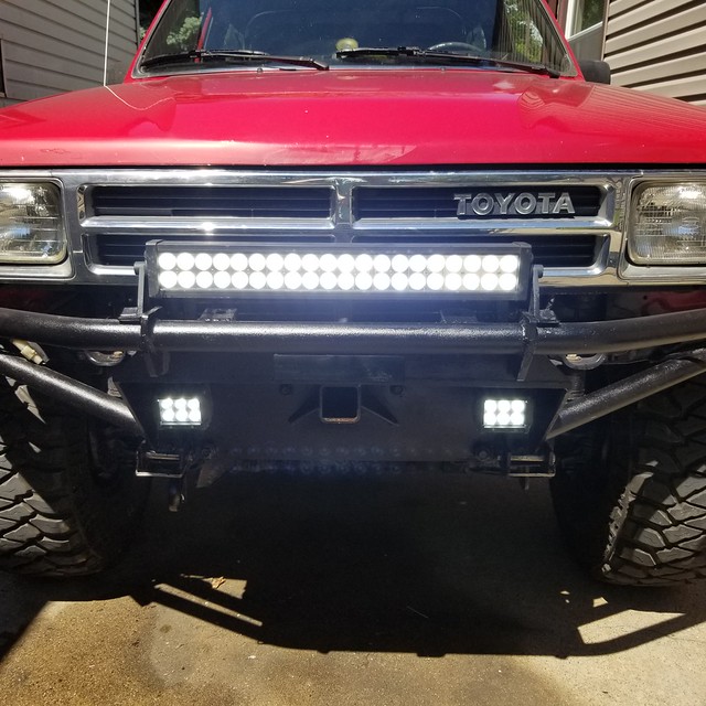

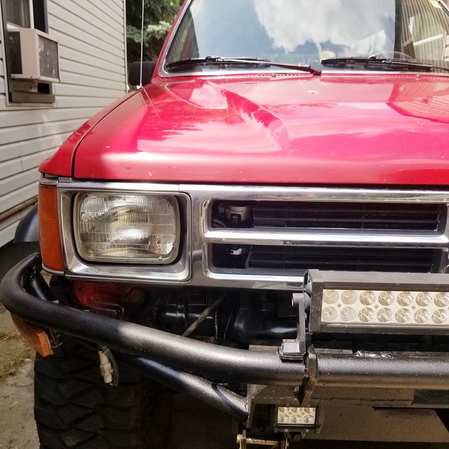

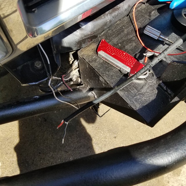

The front light bar had never worked, so I spent time troubleshooting and with power and ground, the light worked fine, so I cleaned up some connections and rewired portions:
Success:
Finally I tried a few different options for the top:

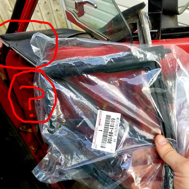

Truck couldn't have been black, because of the red interior paint on the floor :)
I would recommend only the rear OME leaf springs if you carry a lot of weight in the back. They are crazy stiff and uncomfortable for street driving. Also their front torsion bars are ridiculously stiff on a stock truck. I see you have a front tube bumper but that wouldn't make much of a difference.
I believe the PO had stripped the interior and painted the truck fully. I know it was an automatic and they changed to manual so they had done a decent amount of work under the carpet moving some switches and wiring around. The weatherstripping between roof and cab had red paint covering it as well, and black beneathe. Could be wrong, but I know the truck had been in a wreck and rebuilt previously so just took their word for it.

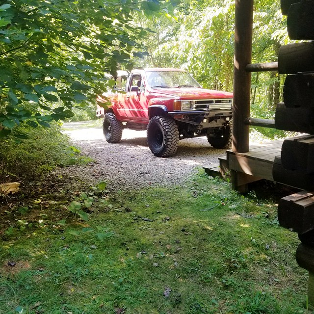

The tube bumpers seem specific to the body lift, so I figured I would either modify them so they could stay after removing or reducing the body lift from 3" to 1" or simply replace period. The rear tire carrier doesn't seem to be rated to the size of the spare, as it moves a decent amount over bumps (the spare).
I also noticed over the weekend that the truck is simply not good on the highway. I have the pedal floored to keep it at 70 (using GPS speedo) and many downshifts to keep it over 65 on hills. I imagine most of that is due to the massive 33x12.5's. Unsure of the gearing, assuming stock. Has anyone downsized to a 31 from a 33? Would moving from a 12.5 to 10.5 make much of a difference if the tire was much lighter? I typically need to drive at least 2-3 hours on the interstate to get anywhere worth wheeling and camping, so getting better fuel economy and drive-ability on the interstate would be very nice.
