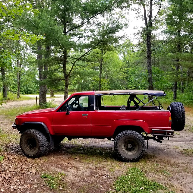

They came on the truck, but believe they are American Racing AR172 Baja. Not my cup of tea, but I have plenty of other things I want to change like removing the body lift which also means bumpers... I'll get there eventually :D
Going from 33-12.50 to 33-10.50s would help a LOT! Steering, braking, acceleration and fuel economy will all improve substantially by going 2” narrower. You could gain some more by going to 31s, but I think 33s are the perfect size for these 1st gens. You highway speeds may actually decrease with 31s due to higher overall gearing. You would be quicker up the hills (possibly) but slower at higher rpm on the flats. Just keep in mind that you are driving a 30+ year old truck. It’s not meant to be quick!
Going to 10.5's would allow me to remove the body lift as well? (if I read correctly) I understand the truck is old, but my International Scout could still cruise at 75 without overdrive, as well as the Range Rover Classic. The 4R just wasn't geared for the tire size by the po so trying to decide if I rather go to 4.88's or move to a smaller tire. I do love the 33's on it though, just don't much like seeing so much of the frame.

What engine do you have? 22RE? My truck is fine with 33x10.50s with the V6 auto and 4.30 gears. The 5 speed should be a bit better? Is your suspension original? I’m running OME and have lots of wheel well clearance. I’m not a fan of body lifts either, but if your springs are still original, you will probably want to upgrade them whether you go to 31s or skinny 33s. They do make a 32x11.50 as a middle ground, or if you go to 16” or 17” wheels the metric size options are huge.
The truck is a 3.0 with a 5 speed. Unsure on suspension, assumed oem.
You most likely have the 4.10 gears then. One relatively easy solution is to swap out the 3rds for 4.88 ones. They are quite common in the 2nd Gen 4Runners, and bolt right in. That would bring up your mpgs and help with drivability. In the pics you’ve posted, the frame doesn’t look like it sticks out too much. Probably easier to keep rust at bay if you can get to the top of the frame too?
That is one optimistic way of looking at it, and is a good point. I am in Michigan after all. I will take a look at the thirds and think on it for awhile.

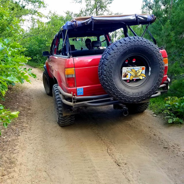

The truck gets its first longer shakedown this weekend. I am taking my gf and pup up to camp and follow a GAIA route i worked on in the national forest a few hours from me over the weekend. I am very excited.
The truck did great, albeit the highway required lots of shifting down to 4th on hills.

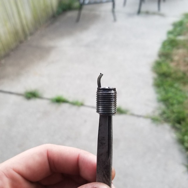

After losing power after coming home from work yesterday, I decided I had better get around to replacing the spark plugs as I had already replaced many other components in the ignition system. I got to the last plug and SNAP, it sheered off, leaving the threads in place. I was out of gas for my torch so was unable to remove using the spiral extractor. I will pick up gas and more penetrating oil today, and have a square extractor set being delivered today. Fingers crossed that I can get the threads out.
