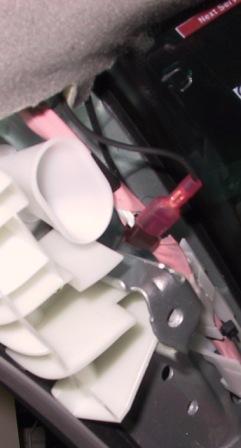

The first thing I did was add an ILE circuit extension to the personal light area. The easiest place to tap ILE is behind the driver's dash/door pillar (two screws). The roof wire bundle runs through there. Within that bundle is a white with blue stripes 3-wire ribbon. The center wire in that ribbon is ILE. Alternatively, the same wire can be tapped at connector 1A pin 8 located at the driver's side fuse panel. Either way I would have had to remove the pillar cover so it made more sense to just tap it in there instead of at the fuse block. I ran a length of wire from the tap point back to the personal light area (with connectors on both ends so that I can easily remove everything if needed). First fish the wire foward towards the rearview mirror, then over to the pillar, then tuck it back under the headliner.

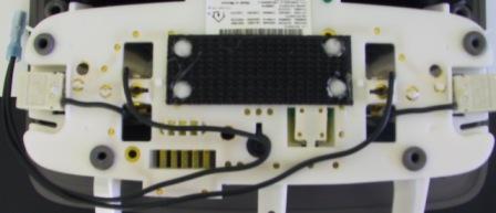

Next I needed to tap the personal light switches. This is easy because the switches plug in/out of the assembly. I used a short strand of 18G wire for each switch. One end of each wire is stripped back about 1/4 inch and pushed up into the unused switch contact. The switch is then plugged back in to the peronsal light assembly. I took some care to route the new wires such that they could not wiggle loose from the switch. I don't want them popping out and starting a fire, damaging my ECU or blowing a fuse. I should probably glue these down just to make sure they never move. The other end of the wires are joined to together into a connector that plugs into the new ILE circuit I added above.

mod'd assembly -- notice the wire routing to keep things clean and secure

tapping ILE circuit behind pillar -- you can't see it in the picture but the wire to tap is the middle wire of the 3-wire ribbon cable in the roof wire bundle. Don't ask me why Toyota used a ribbon cable in there#@%?

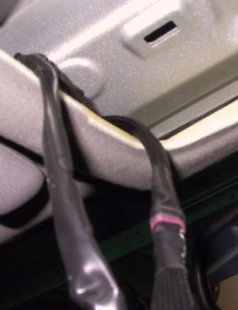

new ILE circuit exiting headliner at maplight opening (OEM wire bundle on left, ILE on right) -- notice the protective covering I added to the wires

First, how did you tap the ILE wire in the driver's door pillar? Did you just use one of those wire clip things or did you actually have to cut the wire?
I used a T-Tap connector to tap the wire -- no cutting.
Secondly, is it easy to pull the wires apart in the 3-wire ribbon that has the ILE wire?
I used a razor to seperate the ribbon wires. There is enough space between them that I was able to do it without leaving any of the wires bare. I just needed to split them back enough to slip in the T-tap. If you don't want to do it this way, the ribbon terminates at a connector in the driver's area fuse panel. It's on the top right if you're looking at the fuses. It's the only ribbon so it shouldn't be hard to spot. If you tap it there you might not need to use a razor to seperate the wires -- it's up to you.
