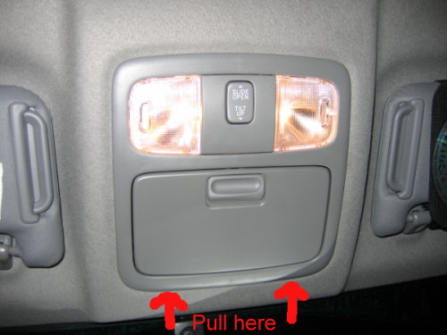

I have only one suggestion for all those who are going to do it. Somebody wrote that when You try to remove personal light assembly (a.k.a. map lights, sun glass holder....etc) You have to pull it really hard. And I did. The only problem was that I pulled from a wrong side. You have to pull it where sun glass holder is installed. This might sound stupid but if I knew this before I started this mod it would take me maybe 15 seconds but instead I was pulling the other side....:arrow: So I attach pic were You can see which side to pull.. Hope this helps
Once again great mod and it is really easy to do.....

Thanks for the removal tip, Krosno. I'm thinking of removing the sunglass holder and replacing it with theOmniFi controller, but couldn't figure out how to remove that sucker! Man, Toyota sure did make it hard to get to the fun stuff!
No problem..
Make sure You post pics after you replace that sunglass holder.....
