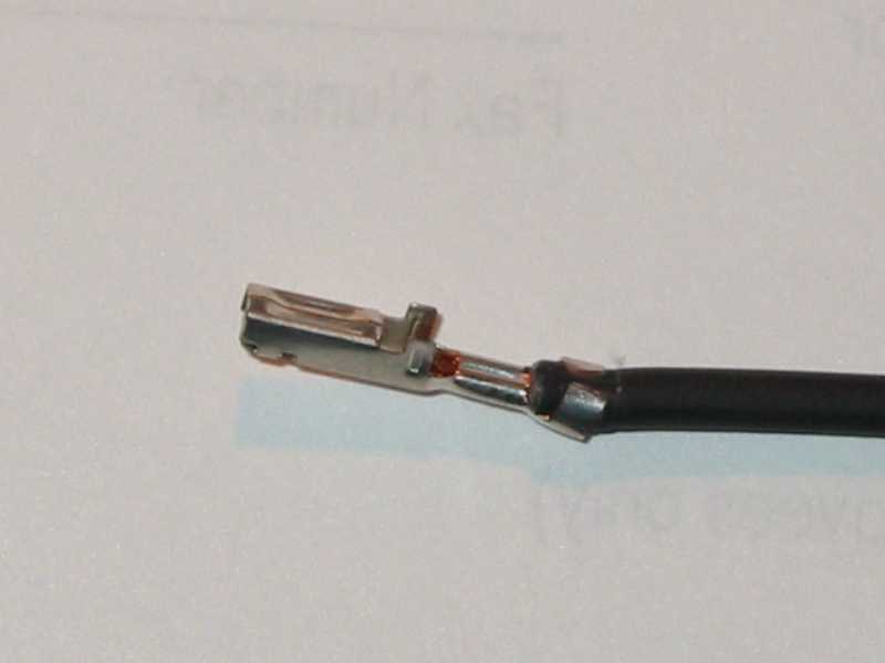

Here is the type of female terminal before the install:

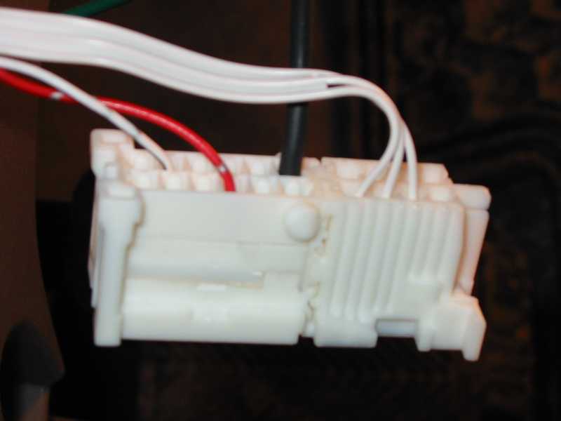

Here's the terminal (new black wire) inserted in the connector:

Here's the connector reinstalled at the junction block:

The second pic above shows that the ribbon terminates at pins #7, 8 & 9. Went to the wiring manual and saw pin #16 was part of ILE but not wired in the connector. Used a meter to make sure it had power but then came the hard part: finding that terminal. Everyone I asked looked at me as if WTF! Finally a local parts store guy said no problem. We search through his collection and it is close to OEM (for $2.64 ea, wire installed). Maybe the stealers have them but I would rather give my business elsewhere.
So you drug the parts guy out to your truck so he could see one of the existing terminals? What store was it?
Almost...
but lucky for him I had taken a dig pic of the existing terminals. I also completely removed the terminal retainer out of the connector block and took that in with me so that I would know that what I bought would fit.
This was a local chain auto parts wholesale counter (CWS Automotive, but try anyone that sells to the service network/garages/mechanics). I am not sure who the specific supplier is but their code for this was #300-580 in the catalog. This cross referenced to a Ford (ughh...never thought I would have to use that word) part #E8UB-14474-BA. I may still look around some more (or break down and see what the Toyota stealership has) because although it is the right size and fit it doesn't hold in the retainer. You can pull it out slightly and break the connection. I want to make it stock permanent so it can't possibly vibrate loose.

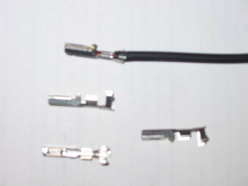

Update on wiring terminal...
Found out the stock terminals with wire from the stealer are C$8.37 each! The original terminal I found with short 16ga wire (C$2.64 ea) comes from an outfit in Guelph, Ontario called SPM Industries (and is distributed by CWS Automotive.) I needed a few more for the rear light mod but they were out of stock. So I found the raw terminal (no wire) at a GM dealer in town for C$2.25 ea. It doesn't have a true GM part # but is a Packard Connectors #7116-1472. See pic below. These are identical ends but are not a pure fit for the Toy connector. They are the right size to fit the slot but they don't clip and hold in place. Solved that by taping them in.
Maybe GM guys around you can help out if you need these. Sorry about the (lack of) focus.

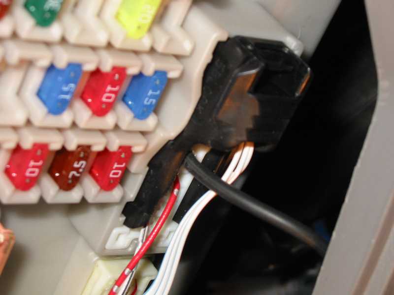

Blade Fuse taps
rando said:
OMG, elite! Where did you find the right terminal?
BTW, for those that were wondering, the picture above also happens to show where the ribbon terminates at the fuse panel.
You can get a blade fuse tap from radio shack for a $1.49. After you crimp your wire into it (I solder it as well for security), they are made to be inserted into a blade type automotive fuse for power tapping purposes.
I just found these a week ago while picking through a parts drawer for something else.
http://www.radioshack.com/search.asp?find=ATC+Fuse+Tap&hp=search&SRC=1&image1.x=30&image1.y=34
