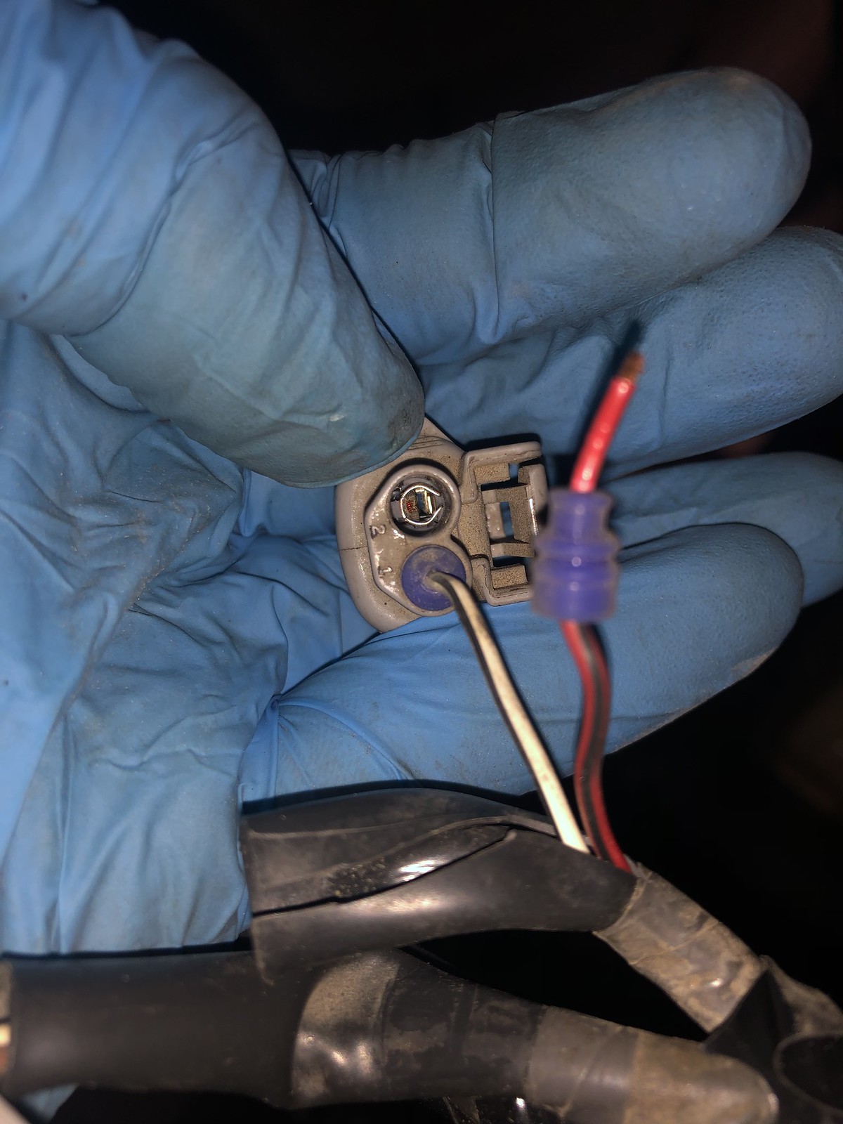

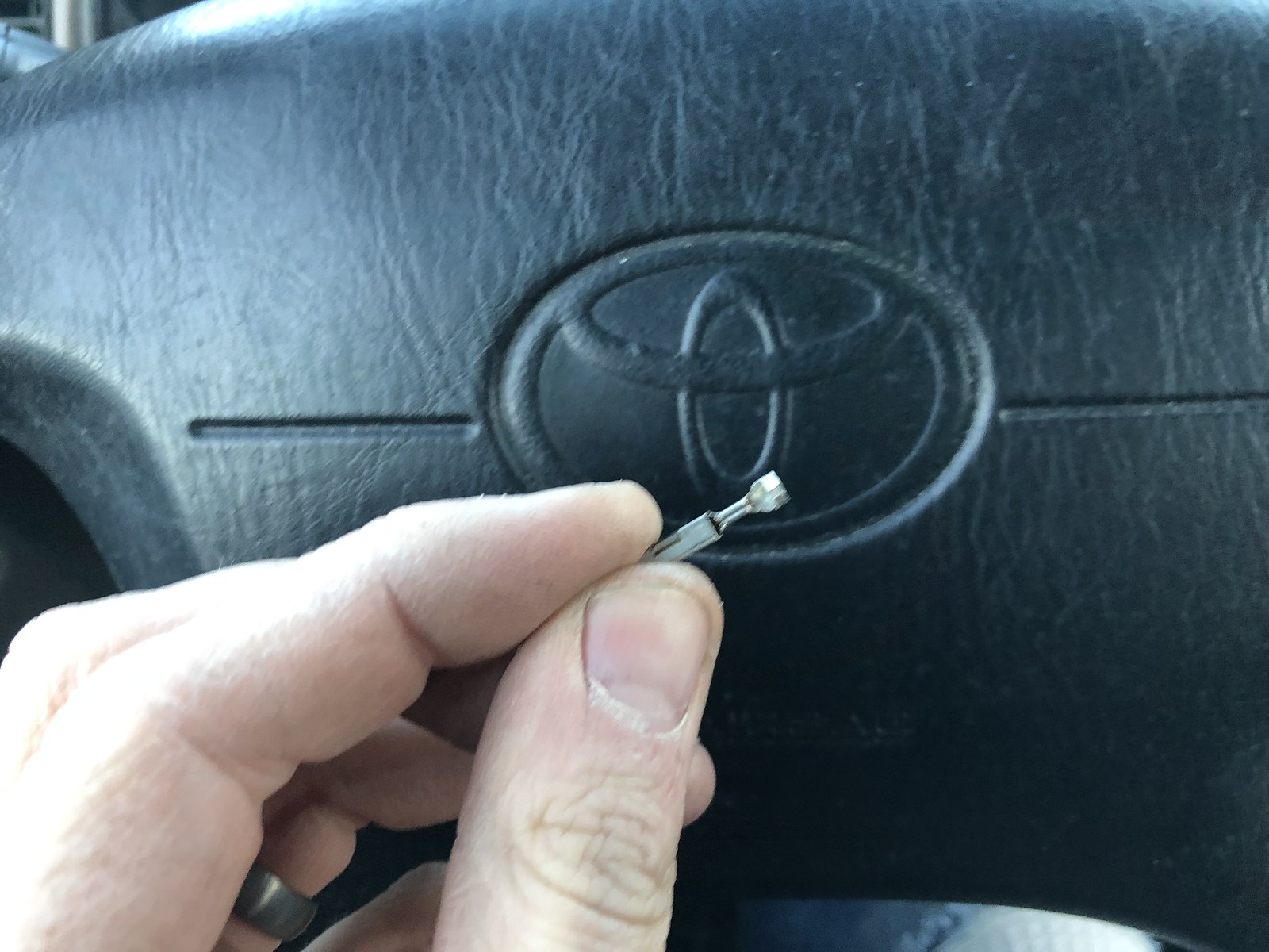

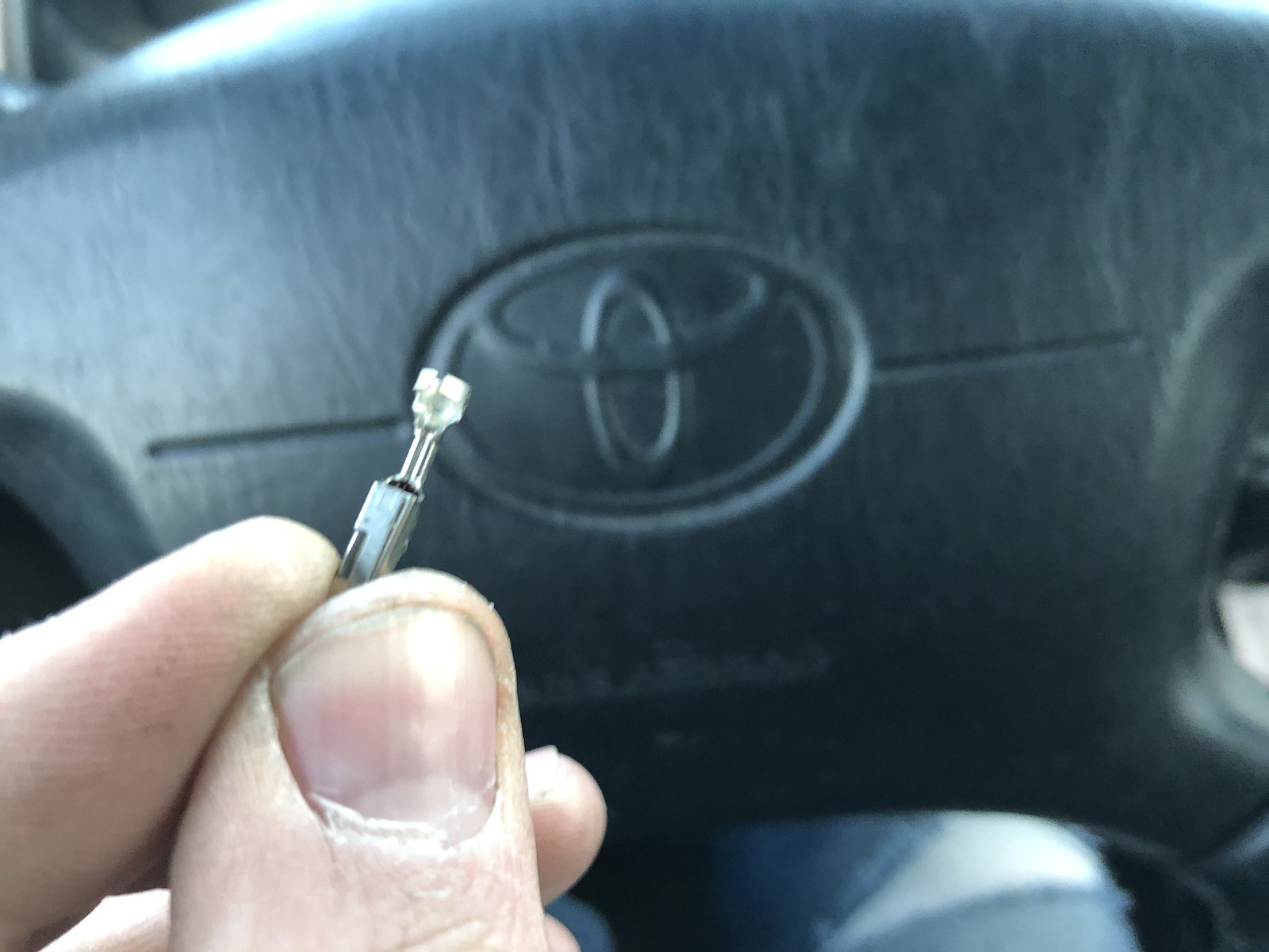

Just wanted to update this thread. I got the chance to dig around in the truck some more. I'm not sure if this was the official issue or if I did it when I unplugged the harness this time but I did find that this plug had a broken wire and it pulled out of its pin in the connector. Anyone know how to repin a plug?? Here are the pictures to follow.

You could just use a crimp and spades to splice the wire for testing purposes. That connector is fairly common and likely at the dealership.

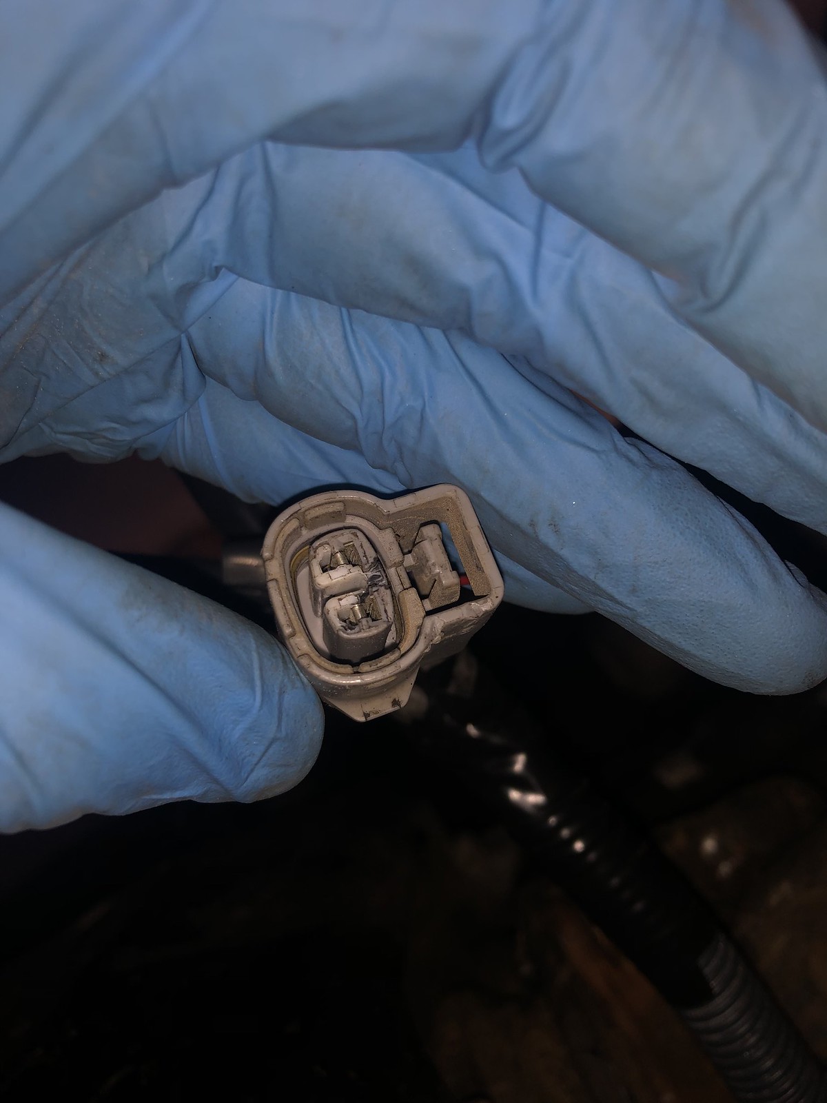

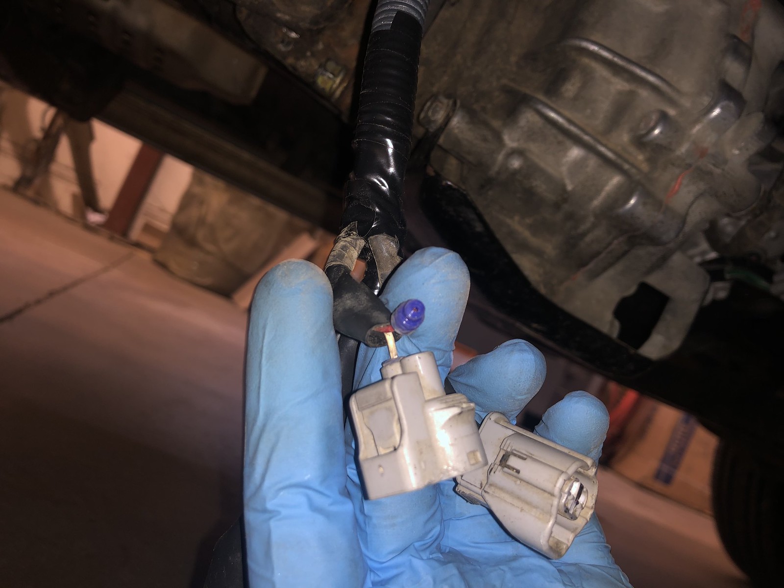

Issue fixed!!
Since so many of these 4wd issue threads don't have a solution posted I would like to update this with my solution. My issue was exactly what is posted above. The wiring harness broke inside of that connector. My guess is that it happened when I did the trans swap, 20 year old wires got brittle. I just pulled the pin out of the connector and soldered it back together. Then when I plugged in everything back in it popped out of 4wd and my lights stopped blinking!
My issue was that the wiring broke inside the plug, I only found it because I noticed that the rubber insert was slightly coming out. If anyone has a similar problem to this in the future be sure and check all of you wiring very throughly. Also please don't do what I did and start replacing parts before troubleshooting and diagnosing. I bought a new transfer case and 4wd Ecu for $300 trying to fix a problem that I ended up fixing for free. I know have a pretty good knowledge of the multi-mode system and lots of wiring diagrams and FSM info on it if anyone is looking. Feel free to PM me and I can send anyone any info I have.
Here are the pictures of where the wiring broke. It would have been almost impossible to see. As you can see this terminal is crimped with a the broken wire inside of it, but it broke clean that you literally cannot see it. Be very thorough it could save you hundreds if not thousands of dollars in the long run.
