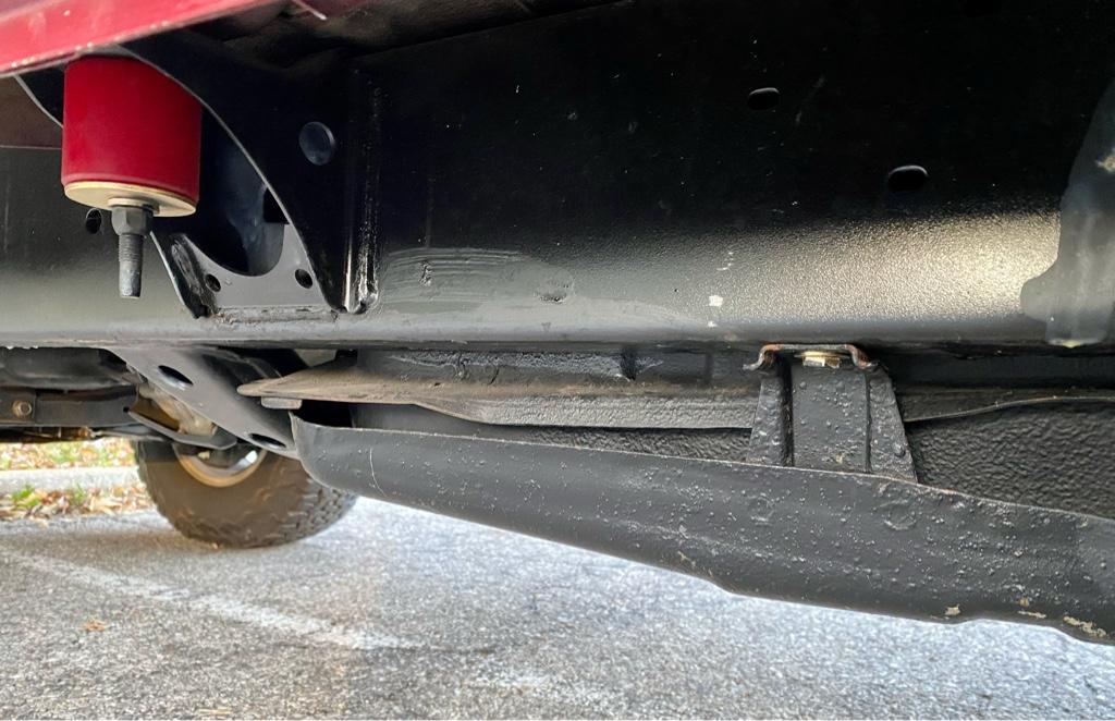

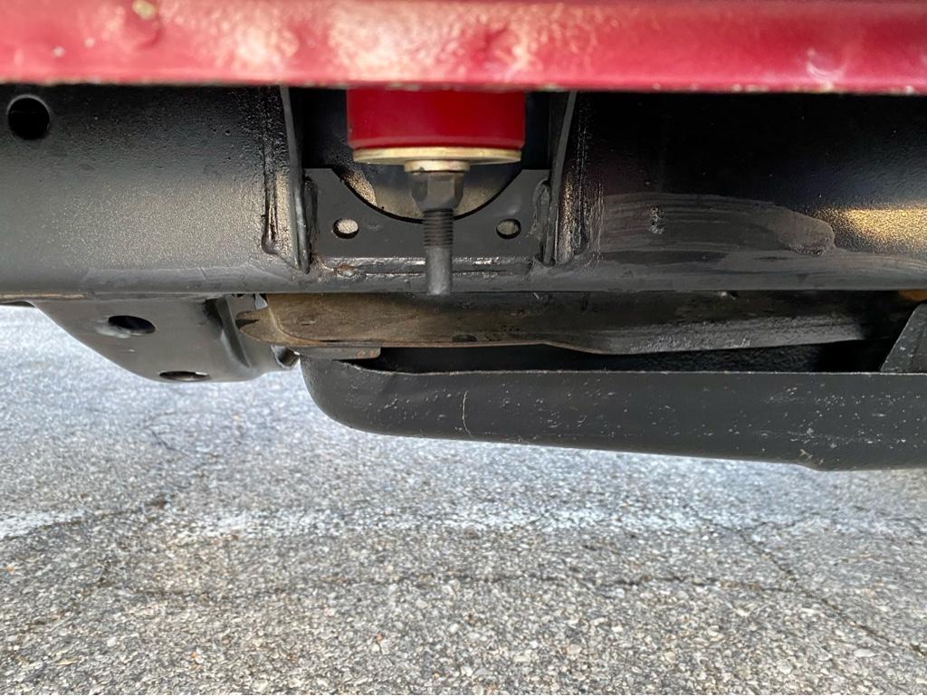

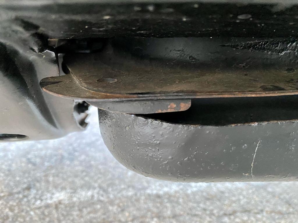

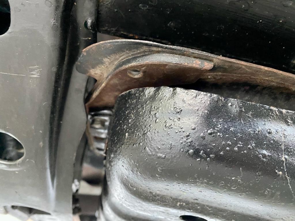

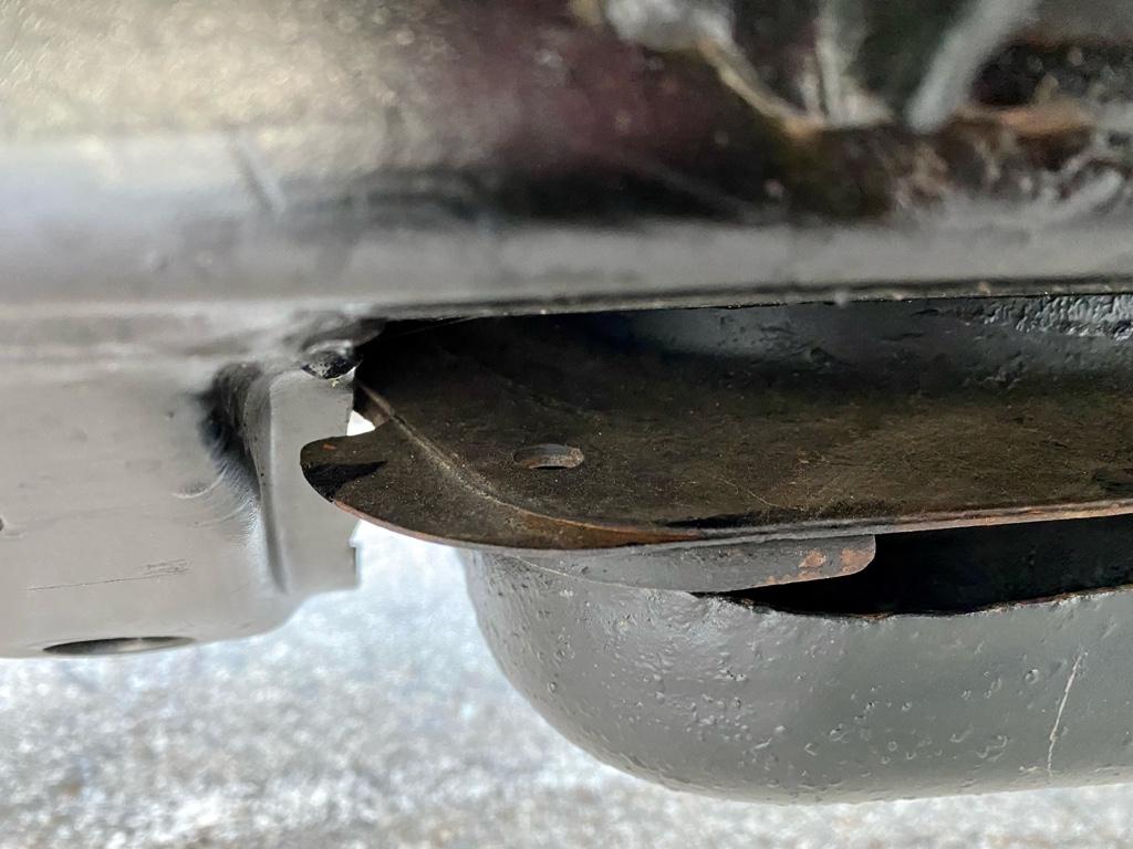

This morning I saw something I hadn’t noticed since the frame swap. It looks like I’m missing a mounting fastener for the gas tank, but there’s no corresponding bolt hole that I can see.
Thoughts?
What does your gas tank look like in this spot?
I don’t have any photos of that spot from before the frame swap that I can compare it to.
Thanks!
After searching for some photos, I'm starting the think that they all look like mine. I wonder why there's a bolt hole there? :shrug:
It is a registration hole for manufacturing. The top and bottom halves of the tank are aligned on pins when putting the tank together.
Just make sure the front there has all 4 bolts holding the tank up (two on the tank only, two on the tank+skid).
