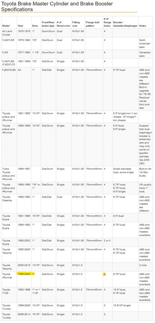

As far as I know, all 3rd gen 4Runner's had a 1" master cylinder bore which is the same as an FJ80. I'm pretty sure the FJ80 is a 4 bolt flange and the 4Runner one is a 2 bolt flange as well. I don't have time to read through all the threads but here's some you might look at:

Already went down this road, not possible I don't think. See below

The posters who said that the Land Cruiser master cylinder has a four hole mounting pattern are right. I have mostly worked with older Toyota pickups and 4runners where the Landcruiser master cylinder is considered an upgrade for disk brake conversions. They share four hole mounting pattern as well. It seems that the third generation 4runner was the first to get the two hole. Thanks to those who gave me the correct information.
