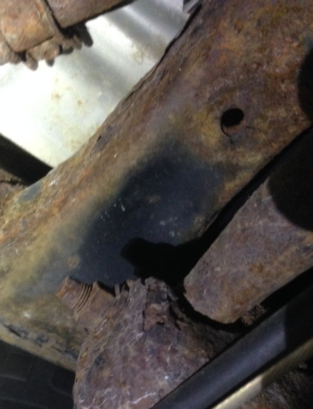

I finally got the truck up on a lift the other day so I could do a good inspection of the suspension components and other parts of the undercarriage. I'm in the process of shopping for lift components but I wanted to beseech some of the more experienced members here to give me their opinion on my rust problems. To me, it looks only like surface rust for most of the components but I'm not experienced enough to notice if I'm missing anything important. I'd like to continue to modify the truck to include a 3" suspension lift but my issue is debating whether or not to find the "rust free honey" I've always wanted or to consider what I have as good enough.
Truck was bought in New York where the salt does some work.
On a second note, my dust shields by the front brakes are rusted through. Is there anything wrong with me taking a cutoff wheel to it to remove the corroded metal?
Gas tank skid is in terrible shape and I'll probably be looking for/fabricating a new set of plates in the future.
wow, I've never seen dust shields that bad. The big problem could be frame rot. Take pics of the frame & post them here. Especially on the rear passenger side. It really bothers me when previous owners don't take care of their rig when they live in the salt belt.
See the drain hole. That doesn't look so hot.

Too much rust for my liking. My 4runner spent all of its life in NJ and doesn't look anything close to that.

I just replied to your post on my thread. Mine is in a similar state to yours I'd say. Can you weld? Or do you know anyone? That makes up for rotting away metal. That was my key to taking on my project. I have a few things that need serious attention and other that can wait. It all depends on your skill and how much of a project you want to take on. I'm new to runners but not to offroad vehicles or rusty ones at that. Hit me up if you've got more questions.
A good grinder and wire wheel will answer a lot of questions. Is the frame soft?

Be sure to keep an eye on that welded on rear dif cover.
You should be checking both sides of the inner frame right where the lower control arms mount, so right next to the muffler and right behind the gas tank....that is the first part these frames usually fail in. Only thing you can do is patch the frame to what's left of solid frame....I have done it on my truck and it's working well. But if you want to spend thousands on a suspension set up then I think you should find something cleaner to start with otherwise eventually you will be pulling it all off the rusty frame truck and selling it or transferring it to your new truck.
Most of it looks superficial. Mine wasn't in much better shape... the dust shields were definitely not that bad though. One concern for my would be the panhard bracket on the axle. Looks a little more than surface. I'd also be curious about the inner frame rail where the Lower Control Arm bracket is in the rear. Both sides (exhaust and gas tank) That's where you'll actually get the rot...

Thanks all for the replies. I'll head out soon and snap a few more pictures of the frame points that got brought up.
