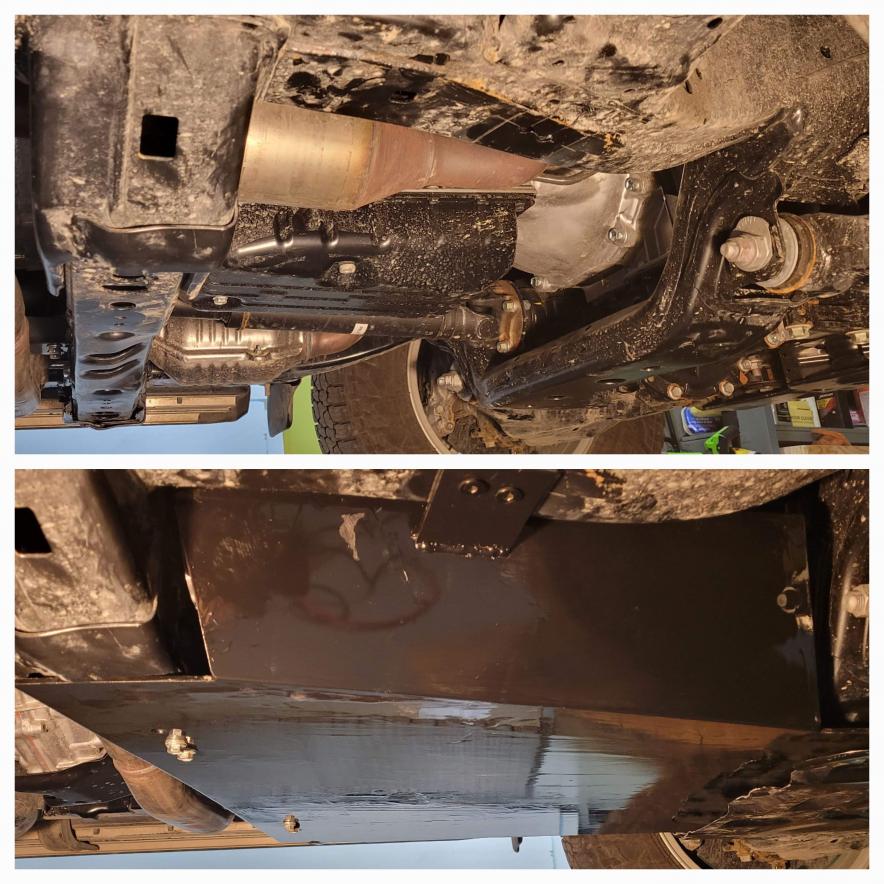

May I see some pics of your concoction?
Thx.
Here is a Picture of the plate I made for my 5th gen, its a 3/16" thick plate.
I did a cardboard mock up and adjusted as needed before cutting the final shape. Bolts have been replaced with a few different types of heads including allen heads and some other features.
I removed the two skid bars that connect the cross member to the chassis. (i'm not going to debate the purpose of them here .. it will turn into the usual OEM vs sparkplug type, ball joint rathole that usually starts- feel free to check the 5th gen section for more drama/ info).:argue::guitar2:
