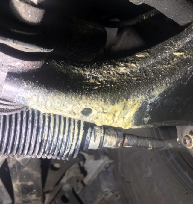

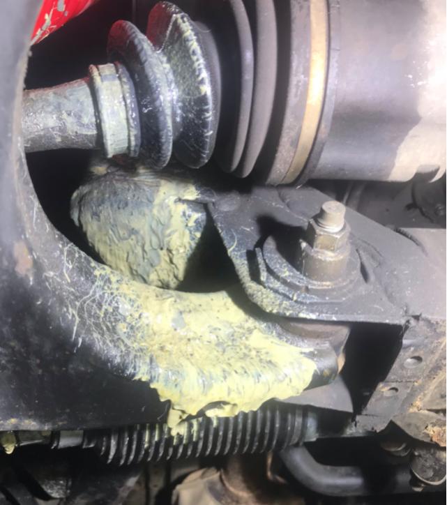

I was installing my VLED hyperflash resistors last night and noticed something on the control arms and axle boots. It is on both sides but I can't seem to find a source for it. It appears like it might be grease? Any guesses as to what this might be? It definitely wasn't there prior to the lift install and the new power steering rack.

Definitely grease getting back the CV boot via a bad seal or a crack in the boot.
That's from your axle shafts. It's common for that to happen after a lift with old axles. Your old axles were used to a certain working angle then you lifted your 4Runner and changed that angle and now the boots are leaking grease.
