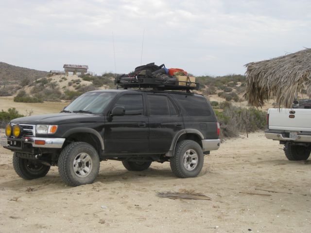

Sonoran Steel Install
I managed to install the SS 1.2 kit with hardly a snag! The R side sway bar mount bolts sheared off when attempting to remove them, so I had the extension plate welded on.
