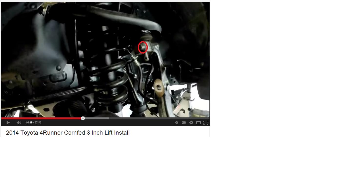

Ok, so is that to push this (circled in Red) out to the right (in this picture)?
P.S. I SINCERELY appreciate you guys helping me with this info.
No you push the pin under the thing circled in red up and the 2 parts come a part.
The part you circled is part of the spindle casting.
