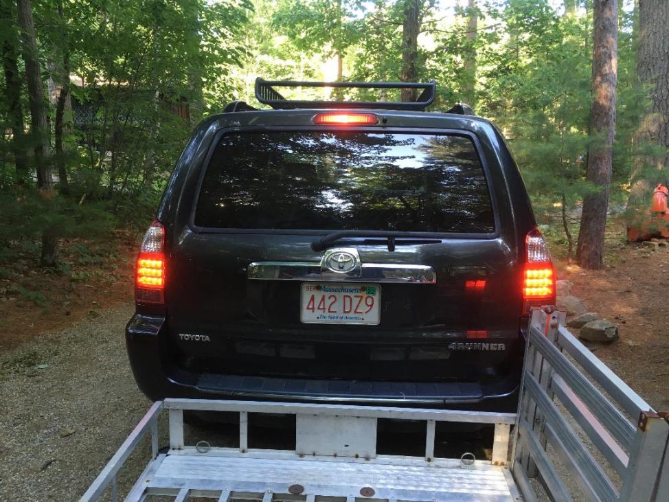

1) people notified me my brake lights are constantly on
2) VSC/TRAC/SLIPPERY CAR SYMBOL is always on
3) acceleration drop outs chronically occurring
4) door locks may be locking themselves
5) most recently, brake lights (all three) are remaining on AFTER the key is removed. they may spontaneously go off/back on, sometimes flicker if i slam doors, sometimes go out if i slam doors.

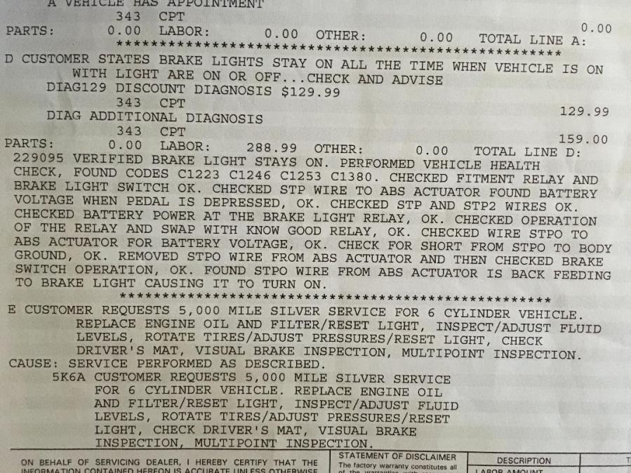

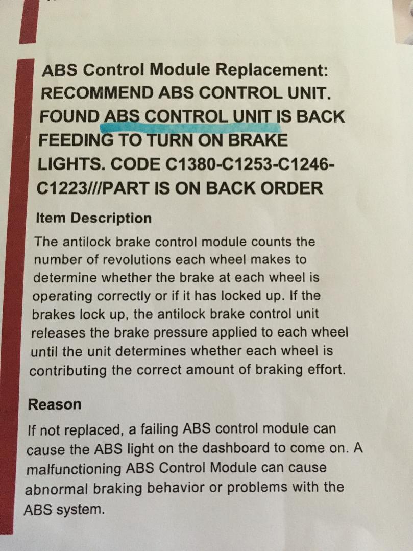

i had even previously bit the bullet and endured a $300 investigation into the situation (number 1 and 2), and they "determined" i needed a new ABS module. they only see one or two a year! i didn't like to odds of it being the epicenter of my problems, but who knows.

2)Without getting into much details the abs module is bound to happen sooner or later, no getting away from it as far as I know.

1) do you mean module, or wheel sensors? service tech told me they essentially never see abs module failure (different than the brake booster. this is the electronic unit on the booster). about a retail $2500 repair.
