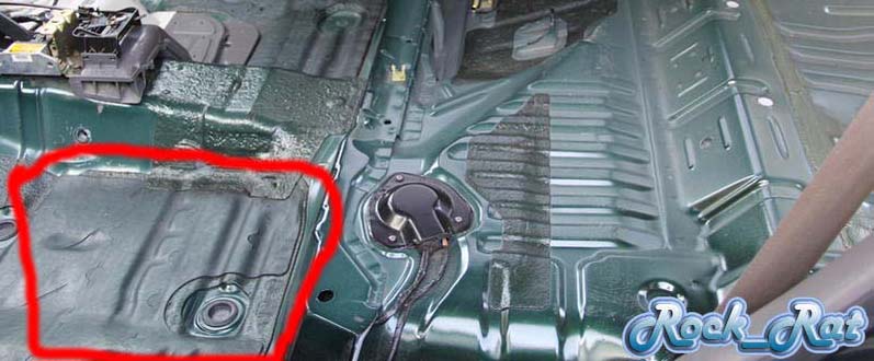

i hope you dont mind, i stole a pic to point out what i'm replacing. this guy was all cracked up (probably from getting wet and freezing repeatedly).
i'll report back when i get the *ahem* accord finished.
dont know why this didn't attach, but this is exactly what i'm trying to fix on the accord. i think you guys have more than covered me with all the options.

use dry ice and use all the safety precautions. it will come off in clean pieces like glass.
i stopped after about half came up. screwdriver and just a tad of prying and yeah it cracks like ice and comes up. i was going to take more pics and finish it tonight but a downpour come outta nowhere. hopefully this doenst cut into my on-demand 12v mods for the 4runner this weekend. :crybaby:
