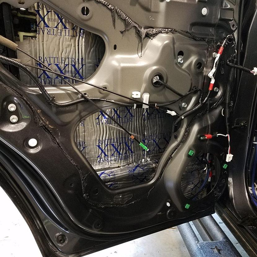

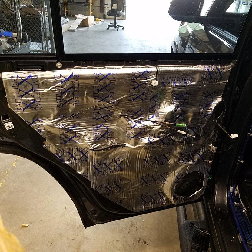

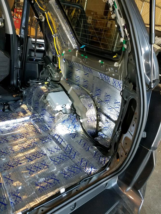

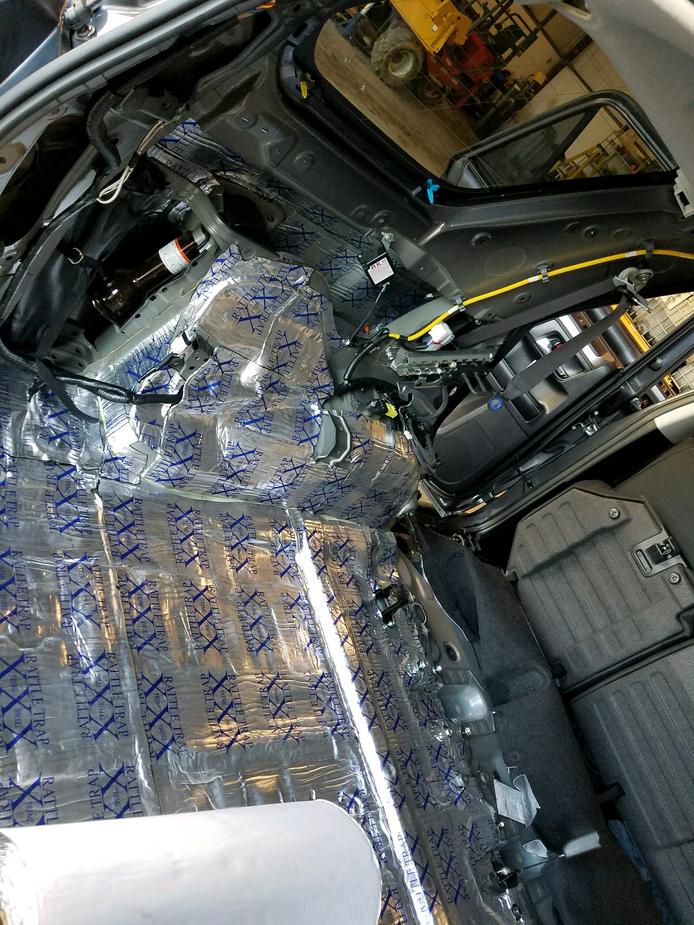

Did mine top to bottom. Made a huge difference.

There is very little else to remove to get the carpet out. Mainly just the bridge between the rear and back seat (2 row only, third row vehicles will be different)

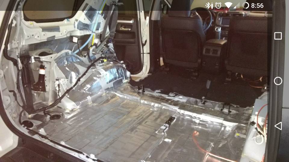

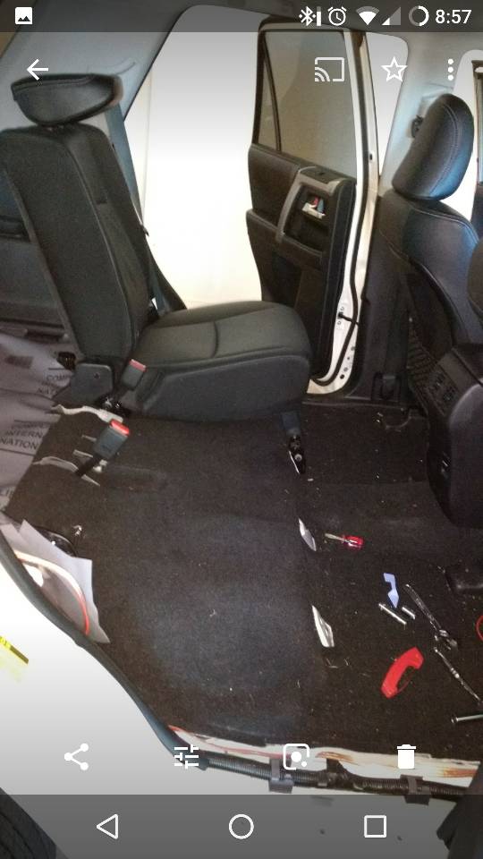

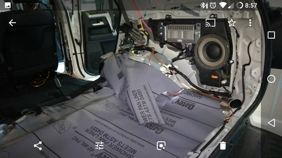

I did the entire floor and sides (not ceiling) from under the front seats all the way back.
Having the right tools, a ratchet set and pry tool is key. The hard part isn't putting in the sound deadening, its getting everything out of the car.
I highly recommend doing it all at once. Start with removing panels from the very back and work your way forward.
I put down both the dynamat equivalent and a sound barrier. The sound barrier was a little tricky because you have to cut it away in certain places to get everything back in place.
I also put a new sub and wired an amp while I was at it. I should have also ran a always on 12v but didn't.
If you remove the front seats or unplug them, unplug your battery.
I need to do the doors but that's it. The floor in the front already has factory sound deadening so limited benefits to adding more there.
I noticed a good amount of road noise reduction and better audio.
