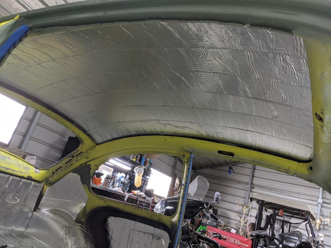

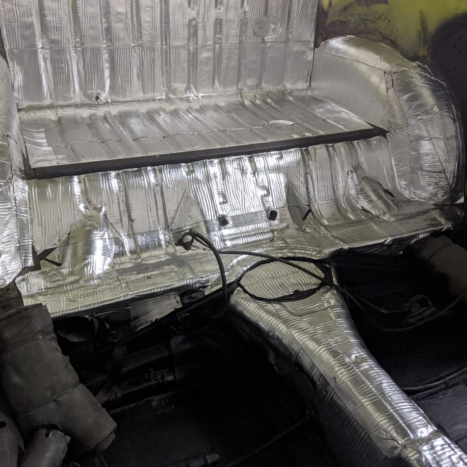

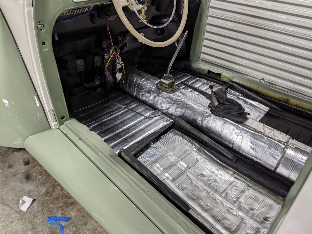

I came across this on a VW site that I am on, restored a 72 for my wife, and did the whole car, front to back for less than $100. I had a buddy come over who owns a car audio shop, and he was blown away at how much it is exactly like dynomat and the other name brand deadeners. $16 a roll, 6" wide and 50' long. Can't go wrong. I ended up doing my 4runner doors with it, I was able to do all 4 doors with 1.5 rolls. I havent done the lift gate yet, but thinking I have enough to do with. It works....
