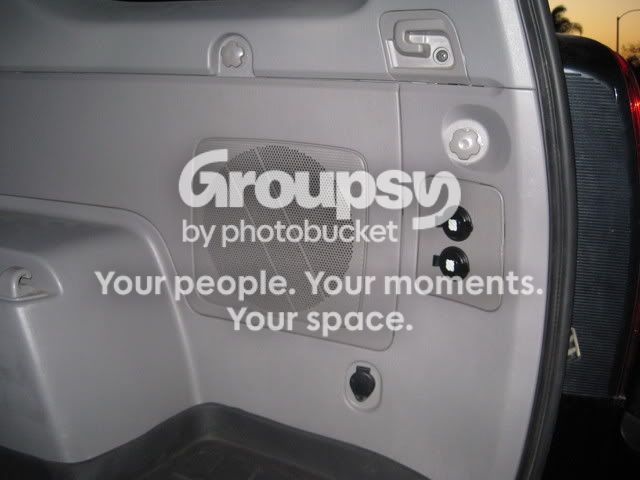

By rear speakers, did you mean in the cargo area on the rear pillars?
josh019.jpg~original
As far as I now, all of the headunits in the 4th gen 4Runner are double DIN. If the headunit is more than ~3" tall it is double din. Regardless, of what it has now, it'll fit a double DIN headhunit.
