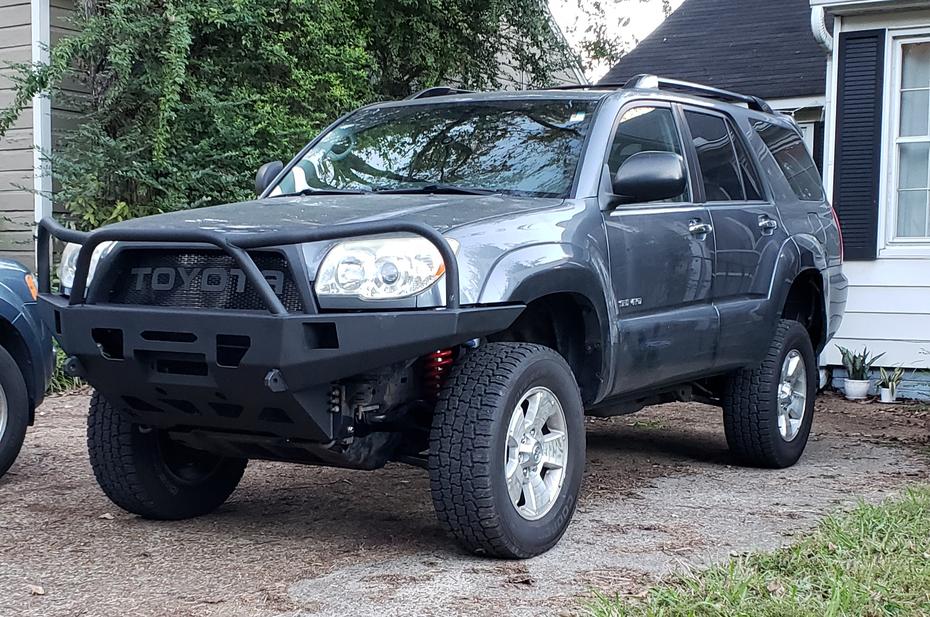

Any pics of the Relentless bumper? Was planning to get the same one but their lead times is ridiculous long
The lead time is miserable, I also got their slider which made it even longer. In all it took 5 months for me to get my order but that's also what was advertised at the time. The build quality is very impressive. I was planning to buy wheels before it arrived but cash is tight rn lol. Overall I think it was worth the wait, by far my favorite bumper on the market.
