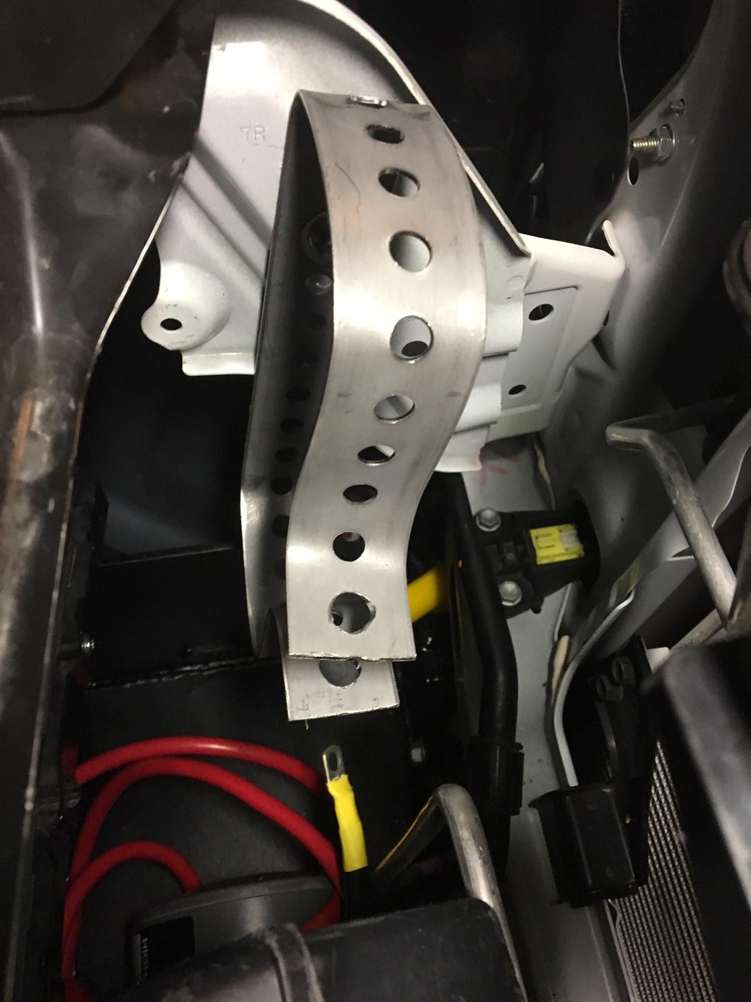

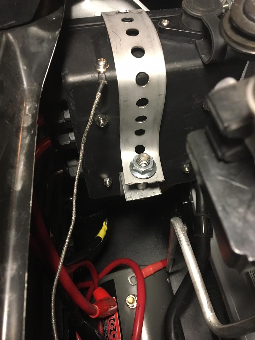

Engo winch with synthetic rope was a great deal that I couldn't pass up so I pulled the trigger. During installation I had some issues remounting the solenoid box, however thanks to [MENTION=102748]Jeff614[/MENTION] I was able to come up with a solution as pictured below by purchasing some sheet metal and a few bolts from Lowes.
Bottom line, an Engo 9000 winch fits in a SSS slimline Hybrid bumper with a soinoid mounted on a grill support with a piece of sheet metal bent around the box attached to a grill support. Now my problem....

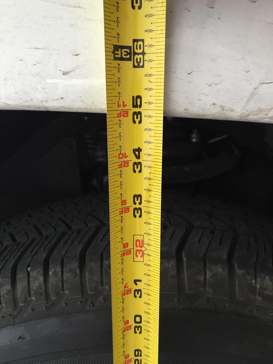

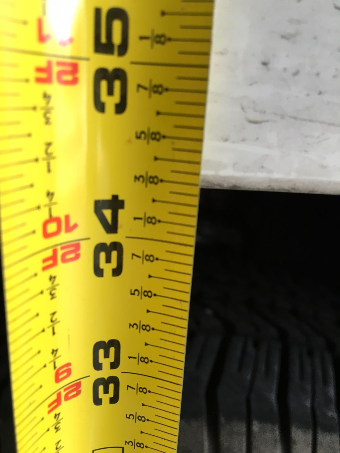

Both great ideas. I went out to measure how high I needed to lift it and noticed that the front drivers side measured 34 3/8 and the front passengers side measured 34 7/8. Has anyone encountered this before? I was leaning towards OME Springs, but based off the measurements I will probably go the coilover route for finite adjustability to even out both sides of the front end. Im now debating between Icon and Radflo, but just want to make sure that 650 pound rated spring will accomplish what I'm looking for.

It's not unusual for one side (usually driver) to be slightly lower than the other with these. And that 34 1/2" to the fender lip is actually about the factory height on most of the 4Runners I have measured. Here is a link to the various OME springs at Toytec. I chose the 885 because it wouldn't be too much of a weight increase against the ~150lbs on my combo. I didn't want any more increased spring stiffness than necessary. My question still is, is that 110 per spring or 110 overall on the 885's?

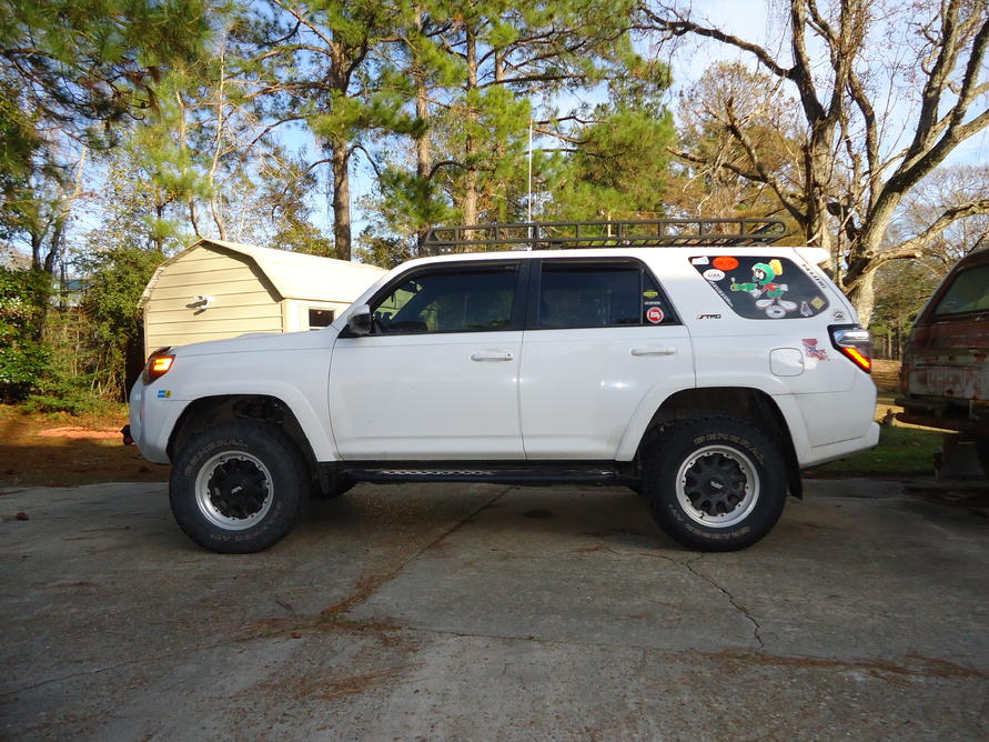

Here's how mine now sits empty.

Sounds like your leaning towards the coilovers :thumb: . If so I think you'll be happy. Mine really improved the ride. It still does nose dive a little, nature of the vehicle I guess, but much less and is the perfect balance of mushy/firm ride. Plus it puts you in a good position for future mods
