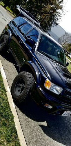

Hey guys, so my rear shocks are just about done. The 4runner bounces way too much from the rear and I'm looking to fix this issue. There is also a noticeably known sag leaning in the rear. I have a 2.5 spacer lift (I was young and broke and went the cheap route) and was wondering what shocks would be the ones to replace them with since the spacers in the rear ones are technically making the truck extend the current shocks on.
Thanks
P.s bought some pro comps 7069 wheels and omg they're beautiful
