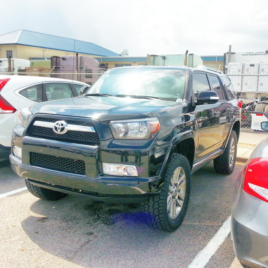

Traxda 3/1.25" spacer lift
285/55/20 Dynapros
Just installed them Monday and I love it. The ride seems a little more stiff but nothing that noticeable.
