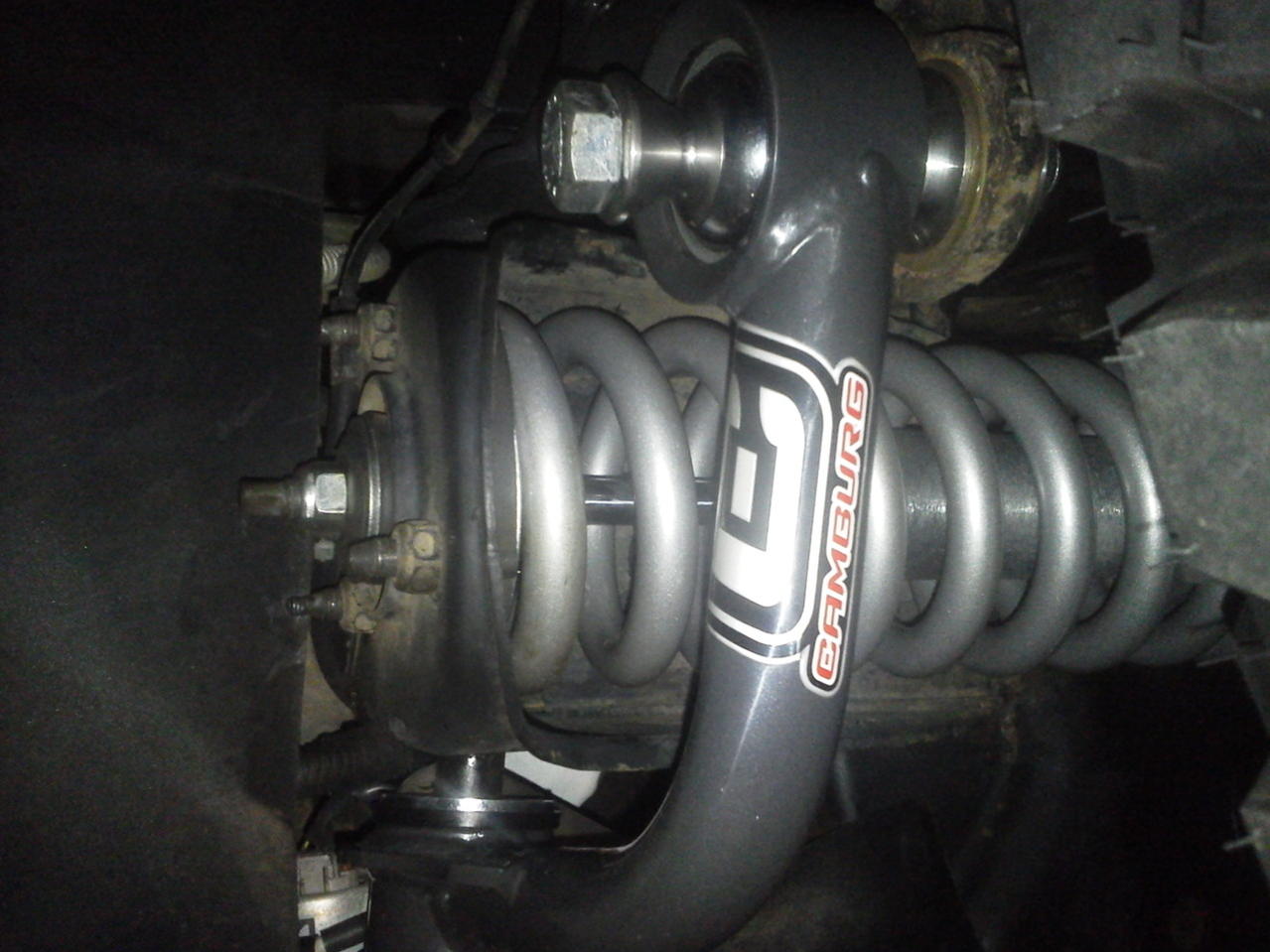

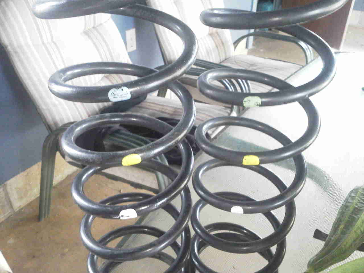

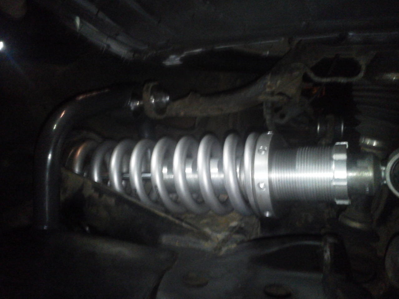

here is the lx450 coils in the rear. the coilovers maxed and a view of the stock top plate spacer.

What's been said in the past is that those LC springs will settle but to speed it up you'll need to throw some weight in the back. I think in the end you'll have 4.5-5"s of lift though regardless to what the lift Faq's say but that's just my opinion considering you have 4"s of rake right now. Those LC coils must not have many miles on them.
I just thought about something....I seem to recall some removed a rubber isolater that the stock springs were sitting on to lower the rear.

Holy hell! Those coilovers are cranked up super high! Does it ride like crap? I'm willing to bet the shock is fully extended, or close to it.
Coil spacers will not work with this setup. You could run a top plate spacer, but there is really no point when you already have adjustable coilovers.
I'd suggest going up one notch with the c-clip and lowering the thread a little (or a lot) on the coilover. Adjusting the c-clip will not affect your droop/travel. The length of the shock is always the same no matter where the c-clip is set. This would just be changing the amount of pre-load on the springs. Putting a top plate spacer on however would give you more down-travel.
And also try putting some weight in the back end to level it out. The LC springs will sag down pretty good with 200 pounds or so in the back.
