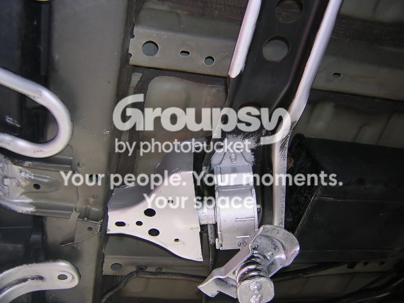

Here is what it looks like with the tire removed, The spare will cover up the mechanism completely

mine looks like the picture above, though a bit rusted, but checked in the truck..and cant see anywhere to release the cable/mechanism...the manual isnt very helpful too, mine has 3rd row option, could somebody point me in the right direction to get my spare tire off?..thanks
The procedure to raise/lower the spare should be in the owners manual. But, in any case, the tools to lower it should be in the rear left side storage area, behind a removable panel. The same place the jack is located. There should be a blue plastic pouch, with all the tire service tools inside. I don't have a pic available, but I do remember there are pics on the forum, maybe in the DIY area. A search should find many threads on this. In this kit, there is a three piece tool, that fits together to make a crank to raise/lower the spare. When you raise the rear hatch, there will be an access hole just left of center in the top of the bumper cover, that is revealed. You insert the square end of the tool in this hole about 12 inches, and it will fit into a socket in the lift mechanism. You just crank the tool to work the lift unit. You will have to get down on the ground, to remove the lift mechanism hook from the spare when it is lowered, and pull the spare out from under the vehicle.
