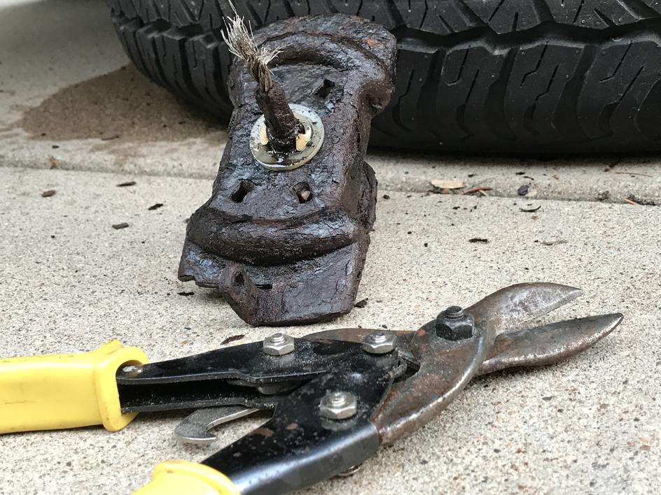

I tried a 3/8 extension and it was just spinning. So I pulled out the tin snips and was able to drop the spare cutting the cable through the wheel spoke openings. Thank goodness for wide openings.

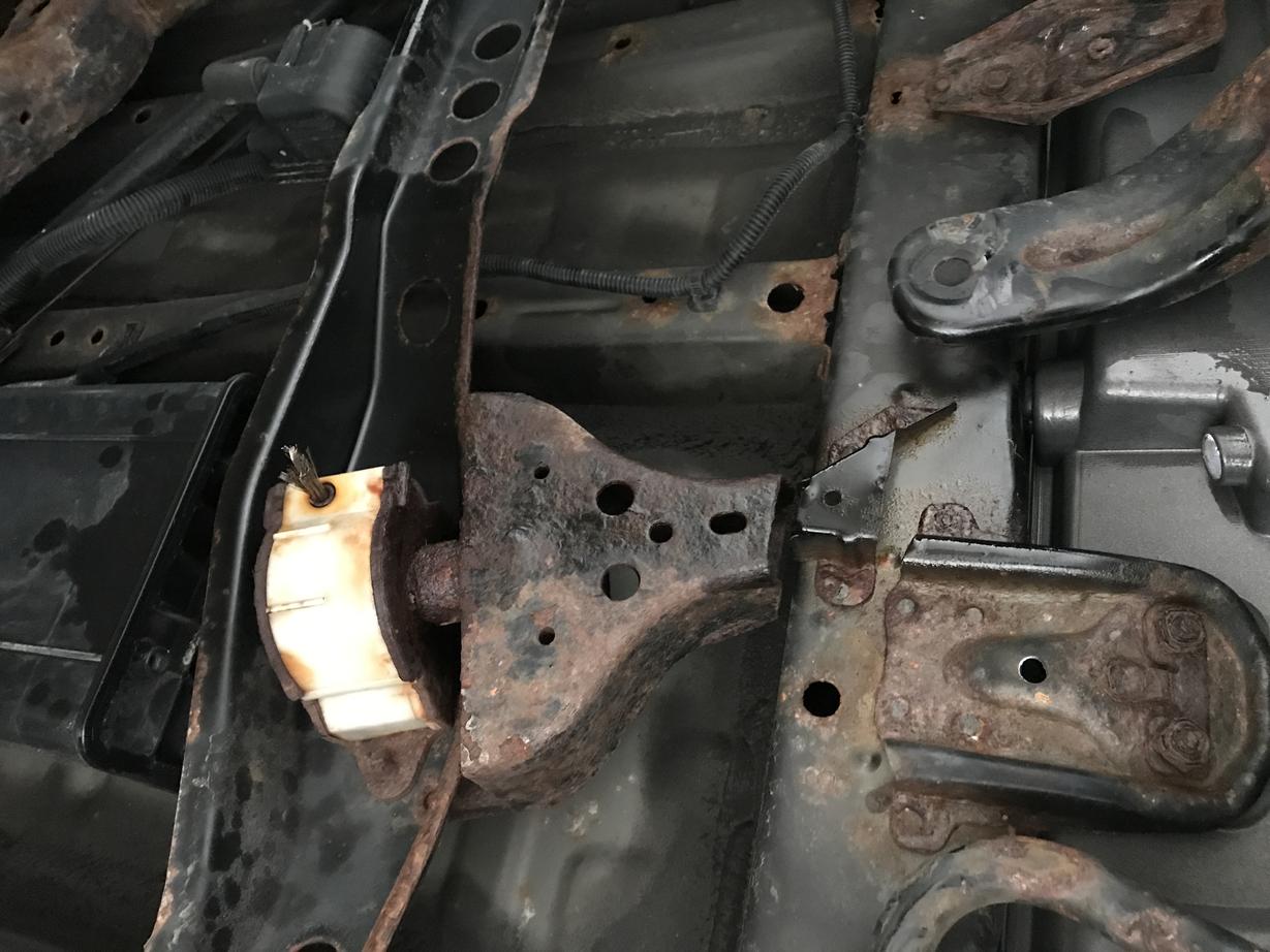

Now I need to get those two screws on the white cable reel out attached to the cross frame. I think they are self tapping bolts with what feels like a hex washer head. It's at such a tight angle I can't even figure out what size will slip on there to get a ratchet on it. Tried everything from 10-14mm. That chalice shaped piece is rusted out pretty good so I may just pry that off for better access.
Glad to get the spare off. It's the same 6 spoke design though its black or maybe just really really dirty. ��
FYI, there are 4 more of those bolts/screws hidden under the winch pulley that don't show in your pic. A total of 6 bolts to remove, and they are ALL a PITA. I found the easiest way to remove them is to cut them. I used an air chisel between the winch flange and the cross member, and replaced them with standard bolts and nuts. Good luck.
Great. I thought that was a bit of a weak attachment for a heavy load. Are they threaded into that winch?
Yes, all 6 bolts pass through the cross member, from above, and thread into the winch base plate. This is why I used nuts and bolts when I replaced my winch, much easier to remove the next time, if needed.
