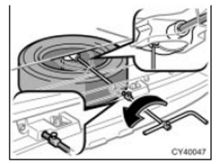

I have a flat and cannot get the spare off, no user manual to check with !
I have the long hooked bar that appears to go in to the rear bumper and attach onto something that will lower the spare but I am missing a trick (I think) as I cannot connect onto anything :bash:

Don't know if it will help, but attached is a picture from the 2006 manual.

took me a while to find the right spot the first time.. I actually crawled under the truck attempting to find/guide it.
Since then, Ive been able to find it much easier.. One tip, the bar does not find it if perpendicular(northsouth) from the bumper.. I find it at NNE, or maybe 1 o'clock.
Sorted,
Brute force required, hook on end of bar fits into a cup not round something !
Many thanks, greased up movement and chain and all works fine now.
