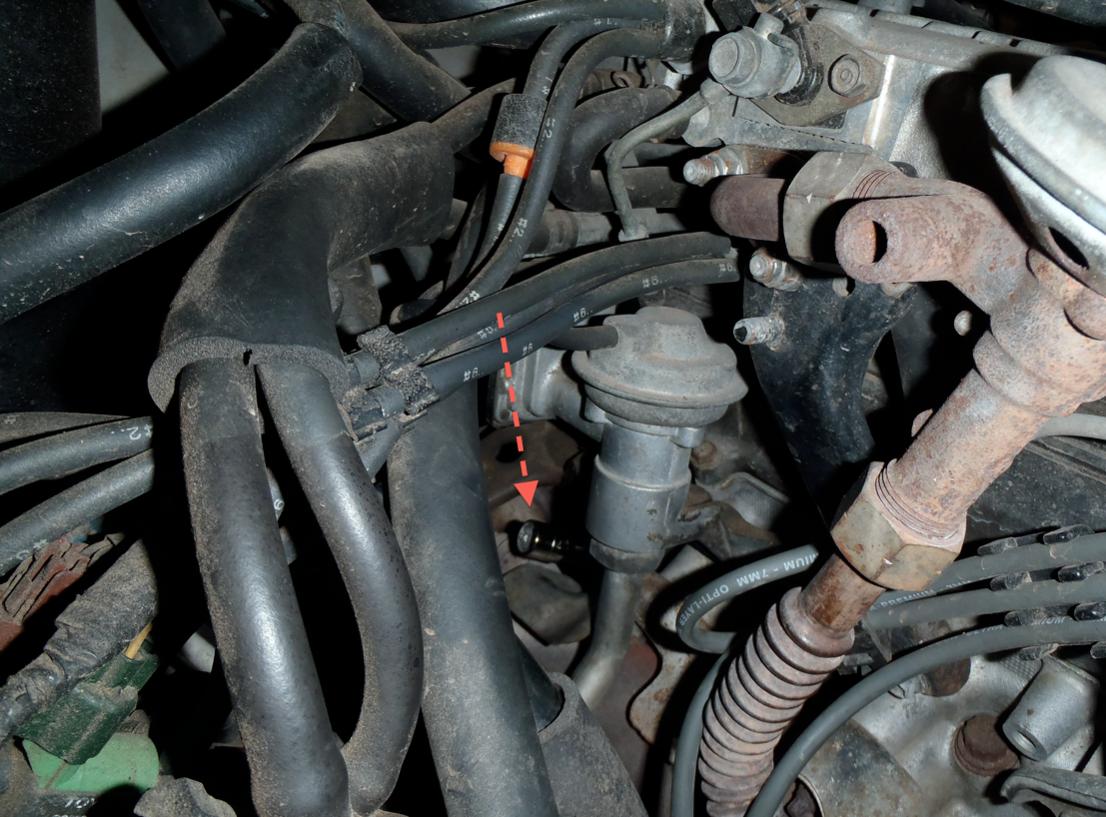

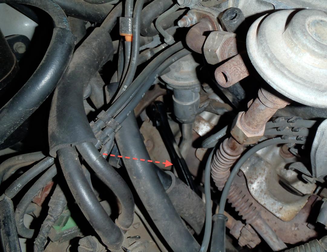

im changing out all my spark plugs in my 91 v6 4runner and i got all of them changed besides the rear passenger side by the firewall. i can manage to get that spark plug in there but it was easy to get the original plug out. if anyone can tell me any trick to get it in there or has a video that can help, id appreciate it
I use a 3/8 short extension. Turn it by hand as far as you can then use the ratchet while reaching in from the front. See below.
Yeah I forgot to mention that you will have to do it left handed. Unless you have a double jointed right wrist.
