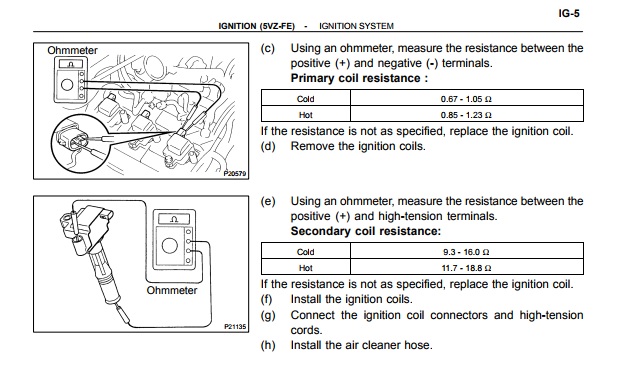

You notice that all wires are 10K ohms or less
The maximum resistance of any spark plug wire is less than or equal to 25K Ohms.[FSM IG-2]
Actually only 1 coil is recommended for these are the same
Coil part number (OEM MFG of the coils and cheaper)
Denso 673-1201
Toyota Part number
90919-02212

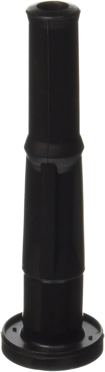

Coil-on Plug Boot
{Recommend when changing the plug wires}
Denso 671-6248 Coil-on Plug Boot

I wanted to know the threshold of resistance on the coils and the wires. Which is listed now and by doing a forum search I found those 2 listed as the most used.

You might also include these. Lots of good coils get chucked when all they needed were new boots. I recommend doing these when you do wires.
https://smile.amazon.com/gp/product/B0013TI3RO/ref=ppx_yo_dt_b_search_asin_title?ie=UTF8&psc=1
IIRC, there is no Toyota p/n listed.

Yes I will add these into the post. I am hoping we get those resistance of these other plug wires. As that would be good to have too.
