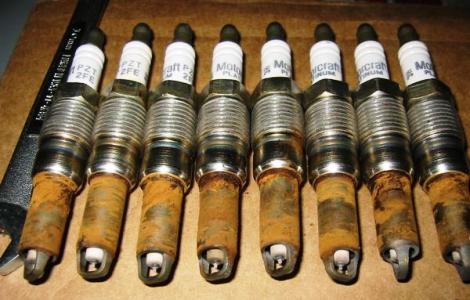

Try replacing plugs on a Ford 4.6 or 5.4 Triton engine if you want difficulty. Those plugs are just about the worst design I have ever seen. Ford will quote the job at about $400.00 because of the possibility and difficulty of breaking the plug in the head. Look at the freakin things.
