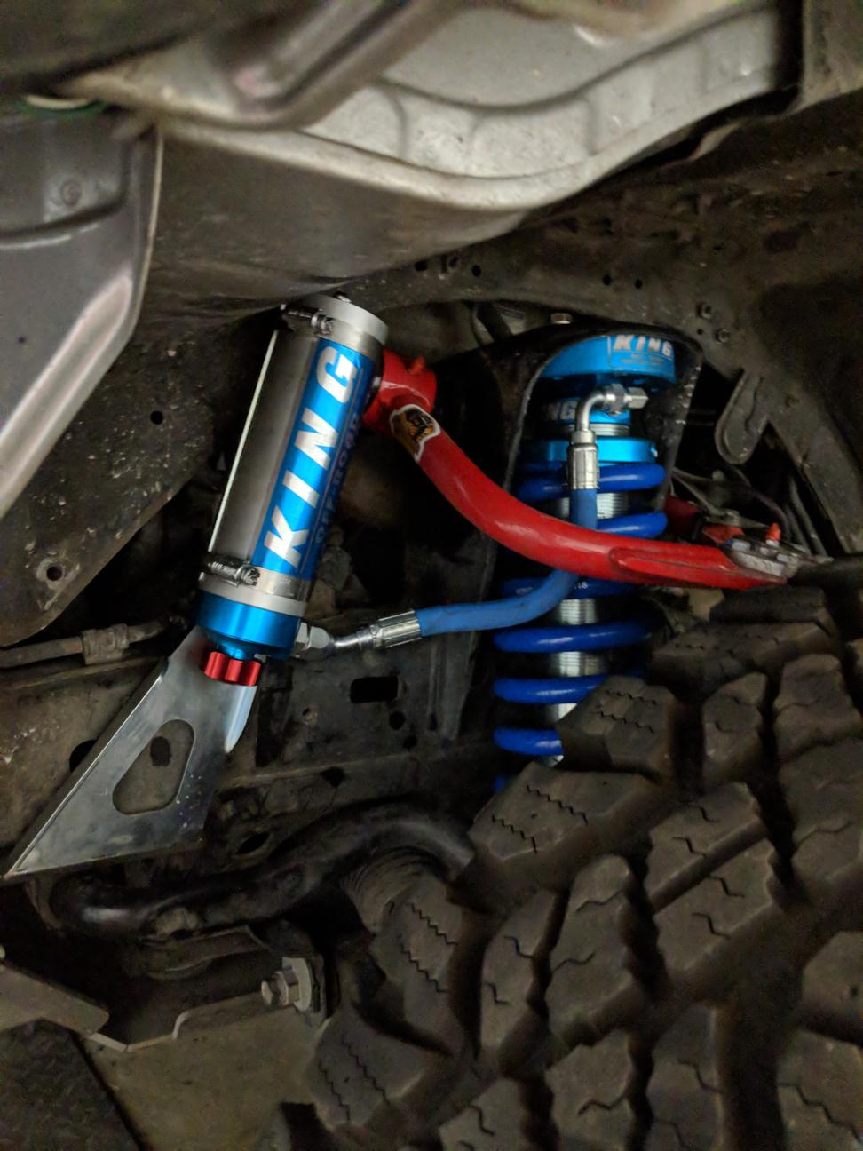

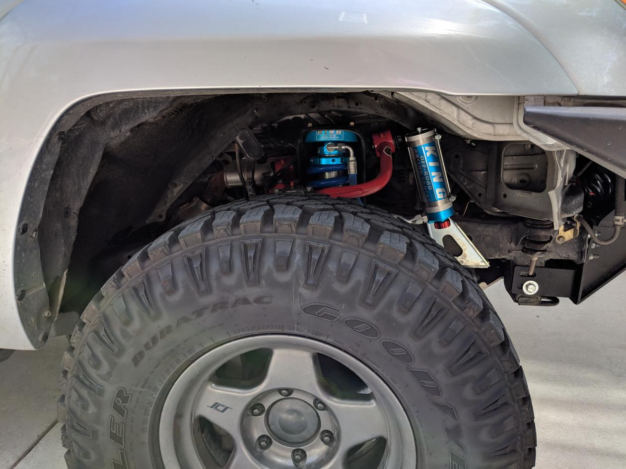

I'm currently at 4.5 degrees positive caster with no problems.
