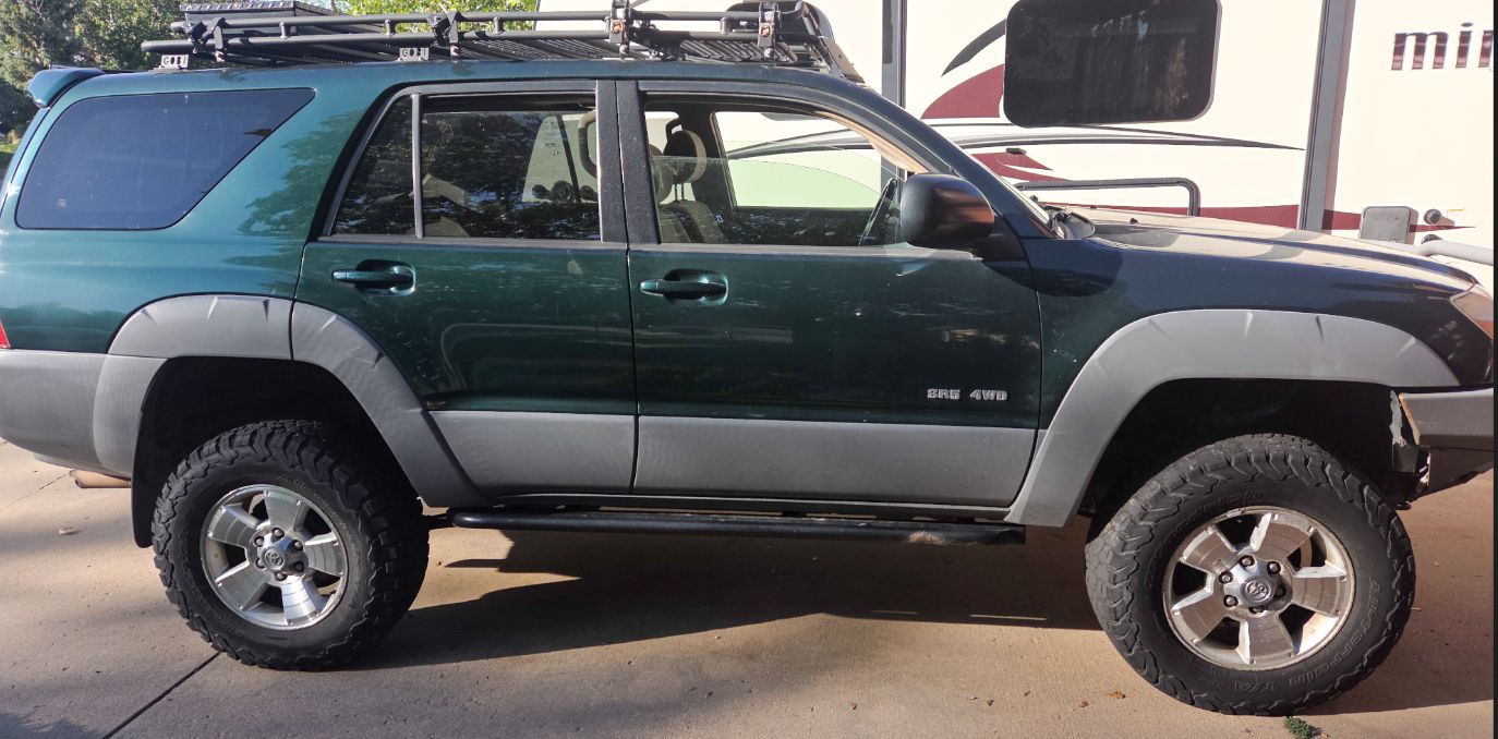

Dealer called these plastic panels "outside door moulding" (see grey "armor" :) in photo...
what are these called, and where is the best place to buy replacements? mine pop away from the body/doors
in locations where the blue couplers broke off the keeper in the grey part. Thanks!

I call them gingerbread or plastic body cladding. I hated them on my QX4 which the 4Runner replaced, only to have the same junk on it.
Anyway, done ranting. Hopefully.
On the aforementioned QX4, I had one on a door that was about to fall off. It gave me warning, it wasn't overnight. Seemed there had been a previous repair, probably 10 years or more, not overnight, that was not up to factory standards and was failing. Clips that didn't clip, some sort of adhesive that had long stopped adhering. It was close to falling off I used a combo of 3M VHB tape and 3M super weatherstripping adhesive. Admittedly sounding like a 3M shill, I'm not sure which did the job, or if it was the combo. but in the 3 years or so I had it after the repair it was solid.
Toyota and Nissan plastics may be different, so what worked for me may not work for you, but that's what I'd use.
Thanks guys! ok, received a quote for replacement "moulding" pieces, anyone have a better idea than black or gray primer directly on the body? price for all those parts -

Thanks All! i can find the little blue and red/orange clips, bigger problem right now is that some of the
attachment point on the gray moulding pieces to engage the clips are broken, so was looking for any reasonable sources for replacing those. It might be that enough of them are functional, that if i use enough of the adhesive/tape in the right locations, i can make it work.
