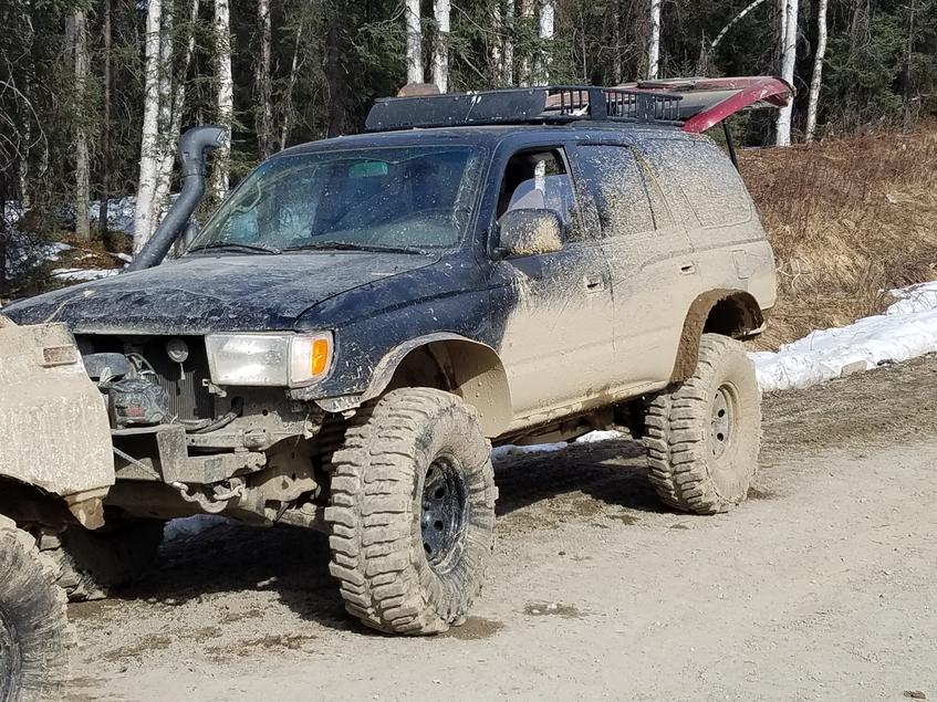

Resurrecting I know, but I'm not really seeing my question answered anywhere. Question is this, I can tell the uniball designed UCAs have a much narrower profile. The SPCs look wider like almost close to the stock profile. Right now, I'm rubbing on the front and rear of my stock UCA when I'm turning. I'm not so worried about correcting alignment issues (I'm 90% offroad) but I do need to make sure they have added clearance from stock so I'm not rubbing on them when I turn. Can anyone that's had a set in their hands comment?
Thank you!

My 285's rubbed quite a bit but clear the SPCs with a lot of space. I also ran some 305s and no issues. They have a lot more clearance than stock, pretty much the same as uniball setups.
