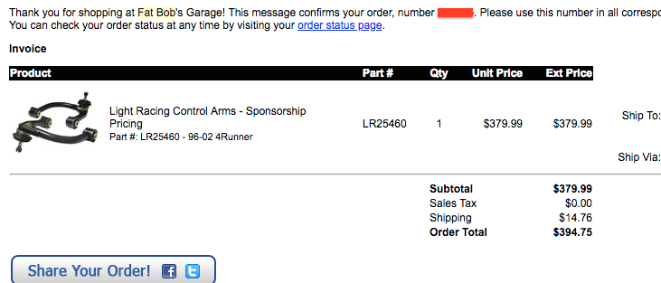

Maybe their policy has changed since I ordered from them but I saw in threads here on T4R that others had gotten a significant discount from them and recommended buying from them, I called and they were very friendly, here is what I paid ordering form them:
