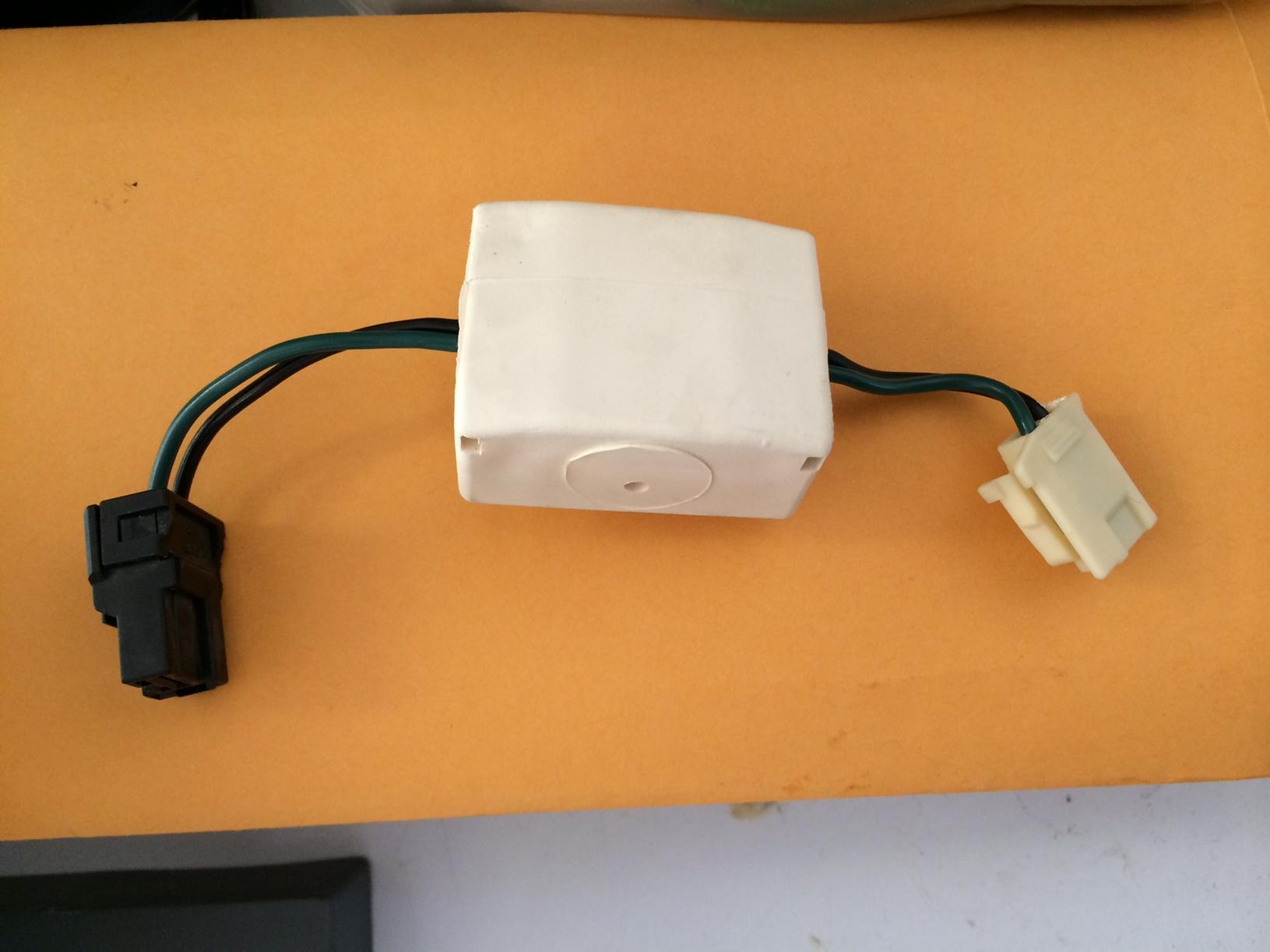

Hi, I am replacing the front door speakers in my 03 with the JBL system. I took out the old speaker and there is some kind of white rubber coated thing wired into the speaker and clipped into a built in part of the speaker mount. My question is what is it and do I need to keep it? The new speakers won't fit into the mount with that thing in there. I would like to eliminate it if possible to simplify the install and I'm in a huge rush as I am leaving town tomorrow on a long road trip. Anyone know the answer? Thank you!
Anyone? Here is the part in question..

Ok, I am ignorant regarding this stuff. The new speakers are two ways, so they have the tweeter built in. So, should I eliminate the crossover and just disconnect the factory tweeter? I really want to dump that crossover in the interest of time and simplicity. Thanks for the replies!
You've lost me. did you purchase a component set of speakers (where tweeter mounts separate from the full range speaker) or did you buy a set of coaxial speakers where the tweeter is mounted to the center of the full range?
Sounds like you purchased a set of coaxial's. If so, you could keep your OEM tweeter installed but leave it disconnected. You won't need the OEM passive crossover as the aftermarket tweeters will have a crossover/capacitor mounted to the back side of it.
Yes, sorry, I purchased coaxials. Alpines. So, just disconnect the factory tweeter and I should be set, correct? Thank you.
I have to be cautious here as I do not know the extent of your entire stereo system and whether or not it is all OEM, aftermarket or a combination of both. From my readings on this site, the OEM speakers are 2-ohm and I'll interpret the Alpine speakers are 2-ohm as well.
If you try to keep the OEM tweeters connected this would reduce the total ohms to less than 2-ohms, and you may overload the factory radio/amplifier system. The reason I say keep the OEM tweeter installed is simply for cosmetics so you don't have a gaping hole behind the speaker grill as you'd pick up road noise, etc.
Well, I disconnected the tweeter put the door back together and the new speaker wasn't working at all. I went back in and hooked the tweeter back up and all seems to be working. Does that make any sense to you guys?
wow...that is surprising!
I've reviewed the Toyota wiring schematics and the OEM tweeter and lower OEM full range are wired in parallel. This means you should be able to disconnect the OEM tweeter and the full range would work.
Well that's weird. I hooked the other one up the same way and they both seem to be working fine now. The sound is definitely crisper too.
Yes, the front door speakers are wired in series
