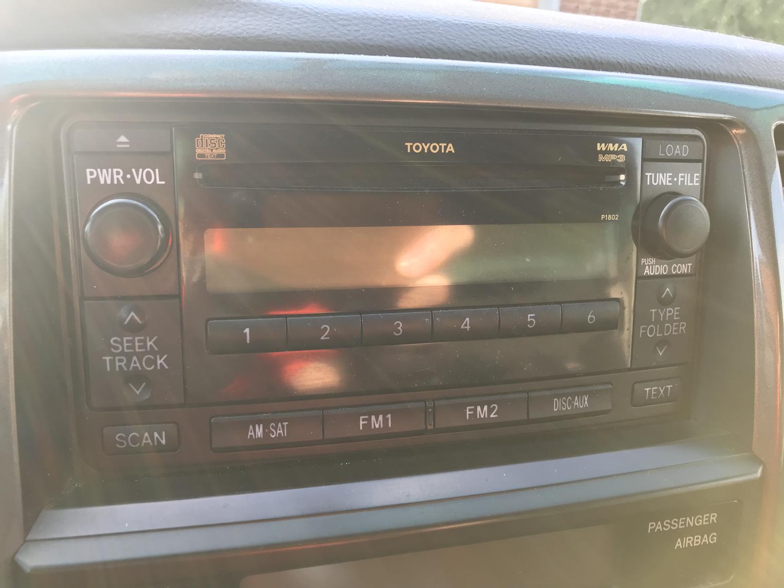

I am stumped. I have an 07 4Runner Sport with the stock CD 6-CD Changer and stock speakers. A few months ago, the driver’s door speaker stopped working. I thought nothing further of it until the driver’s side rear door speaker stopped working as well.
My first troubleshooting step was to check to make sure that the balance and fade on the stereo hadn’t been bumped accidentally and isolated the sound to the Left, Right, Front, or Rear. This step also confirmed that there is no sound coming from the two speakers on the driver’s side.
My next step was to check all fuses in the engine compartment for the stereo. All look perfect.
I am being optimistic and hoping it is not a wiring issue, but it sure is looking like it might be. Anyone have any suggestions on what I should check next, or has had similar issues? I’m trying to avoid a costly trip to the dealer.

I picked up a great condition replacement on eBay dirt cheap. 30 minutes driveway replacement
Are you saying you got replacement speaker/s or stereo?

This could be speakers or it could be the stereo, you need to try and hook up a another speaker to see if you're getting a signal thorugh the speaker wires, IMHO...., you could use some wire and connect it to the driver's side wires and run that to one of the speakers on the passenger's side or use another speaker if you have one laying around.

Just ordered a replacement stock stereo, thank you!
