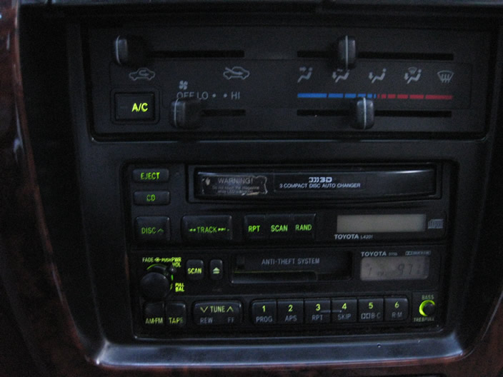

Specific Lights on the Console are out (radio station and heat settings)
prhime
I have checked the ACC fuse and all other fuses (figured while I was in there I might as well).
I have attached the picture for visual reference.
I just inherited this 4Runner and am in the process of giving it some TLC. This is one of the things on the list.

pull the dash apart and check the bulbs. at least on the HVAC it's really easy. if you're bulbs are out, replace them with L.E.D.'s!!!!

I had the same issue with my HVAC light and I changed it. It only took about 10 minutes and I was very slow because I didn't want to mess anything up.
I went here and there were many pictures I used.
http://www.4runners.org/
Remove the HVAC knobs, pull out the AC button, pull the console face off, and then you can pry off the HVAC face. Then it's just a little light that's there. Easy as pie.

i think what Clemsonfan15 meant to say is that if you want to remove the radio bezel (woodgrain trim attached) thats around the radio and a/c control module, your gonna have to pop-up the trim thats around your parking brake, move that up slightly, also pop-up trim thats around the shifter (move aside), then pull knobs off the hvac along with the face of THAT module. if your gonna pull the radio bezel completely off, then there will be two phillips screws on the sides of the hvac module. after removing screws, just pop-out the bezel (carefully). all snap-ins except two screws. hopefully this helps any. keep us posted.
thanks for all the replies. I have swapped the light (bulb was burned out) and replaced with a new one. the condom broke but it I put it back in place. We will see how it looks later on tonight.
It was very simple as outlined above.
-pull off knobs
-carefully pop-off the HVAC face
-even more carefully take of the magnifer
-slide out the bulb
-take of the bulb cover aka condom
-swap in new bulb (it is bulb #74 from any maker)
-and replace the parts
The other half of the problem now is the radio. I can't see what station is paying (sometimes I just like to drive with Scan on to find new stations).
any ideas on this one?
wanted to post an update.
The climate lights are all back. They have been out for so long I truly forgot what they looked like at night.
The only light left is the radio station lights. Any ideas??
