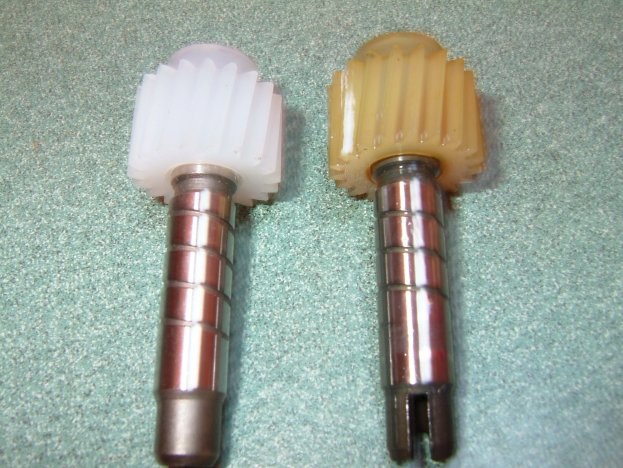

Some threads say I need to go from an 18 tooth gear to a 16 tooth gear. Other threads say there isn't a 16 tooth gear and only a 15, 17, 18 or 19.

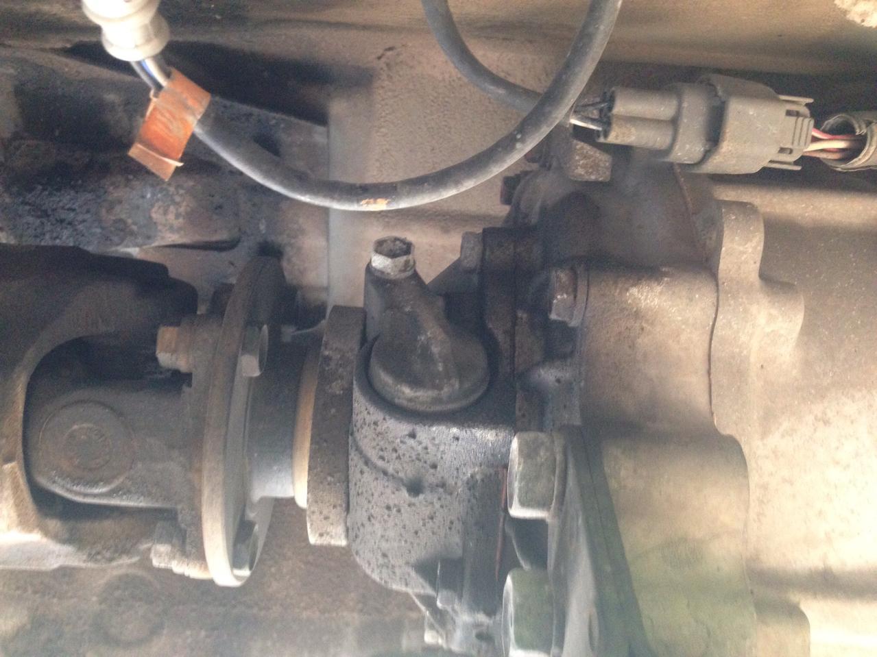

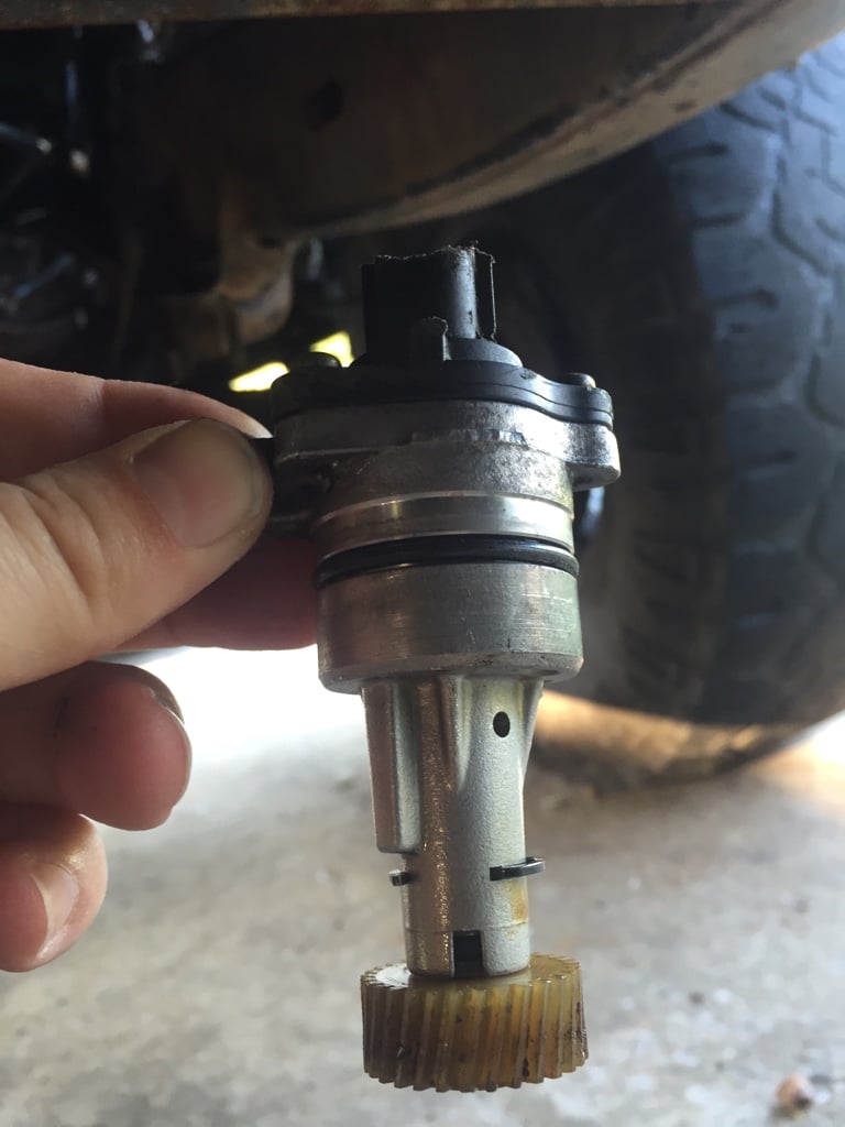

Mechanical not electrical
Since I have a 96, it is mechanical and not electrical unfortunately. Below is a pic of the type of gears that need to be swapped out.
I do appreciate you taking the time to reply.
So you have a cable in there that goes to the speedo? Or do you have something like this:
Confused more
Crawled under and this is what I see. This is where it's supposed to be right?
On a Tacoma, yes.
Ours are on the side of the transmission, but later gens used the pulses from the ABS for the speedo. (Not sure if the 96-98 did the same.)
You're going to want to follow my write up. You'll need a speed sensor from a Tacoma, and about a foot of the harness, unless you want to make your own.
My 96 sr5 (m/t, built 12/95) got the signals from the abs. When I switched to manual hubs I used the Taco sender wired to my speedometer. 33s w/430s has the speedo reading 4% slower than actual speed, according to my GPS. It was easy to do, but not adjustable for more accurate reading like Doc's deal is. Luckily I was able to get that sender from a mightymouse over on Yotatech.
I believe it's the 2nd gens that are gear driven rather than abs...though iirc we can't use the 2nd gen 4Runner sender (feel free to correct me on any of that)

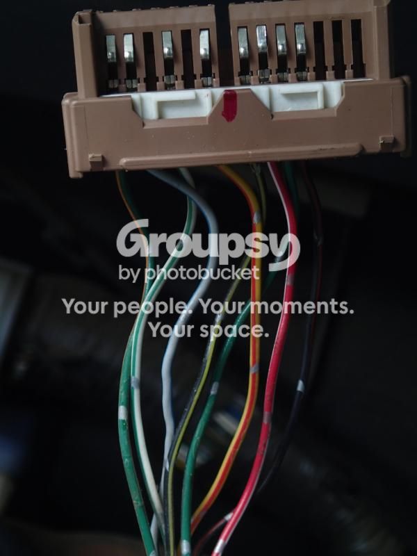

Making a VSS work with a 96 originally ABS equipped 4Runner:
Get the gauge cluster out:
Unbolt the 4 bolts that hold the bottom panel on (under the steering wheel, houses the fuse access panel).
The trim around the ignition carefully pops loose.
Unscrew the 4 screws that hold the rest of the trim around the instrument cluster. Two in front and above the cluster and one at the bottom of the trim on each side.
Unscrew the 4 screws that holds the cluster in.
Undo the 3 plugs on the back, pushing in the tabs to release each of them.
Pull out the brown connector.
We are looking for the
grey w/blue stripe wire for the speedo (2nd pin) and the
Black w/yellow stripe 12v switched wire (7th pin)
P6052642_zps898d414d.jpg~original
Cut the grey/blue wire (I taped the end I won't be using anymore) and connect the signal wire from the VSS for the speedo, leave the ABS signal out of the picture all together.
Splice the VSS 12v wire to the black/yellow wire.

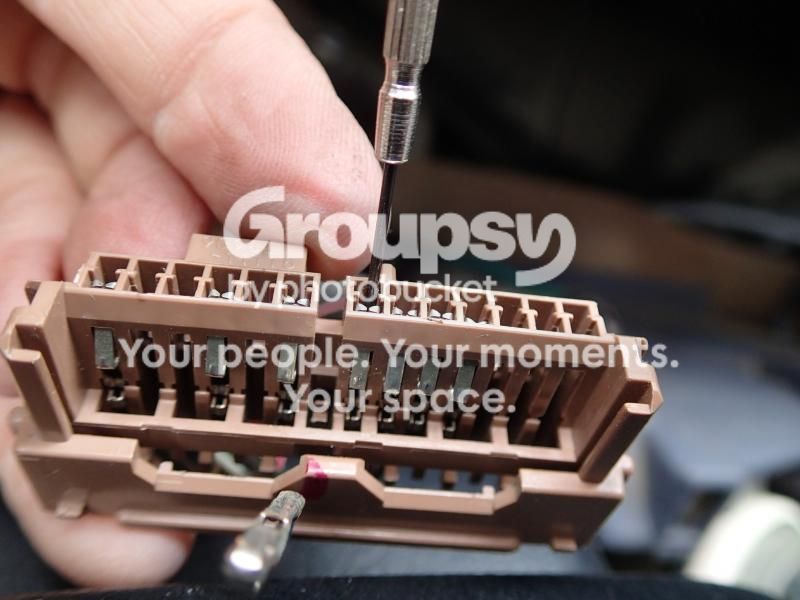

You don't have to, but for better access I removed the pins I was working on by carefully taking out the two white keepers on the connector and simply pulling out the pins.
P6052643_zps9e08ae58.jpg~original
Put it all back together and now pin2 grey/blue goes to the VSS signal wire and pin7 black/yellow has the VSS 12v wire spliced in.

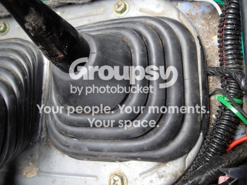

Next I chose to run the wiring between and through the shifter gaskets. I stuck a couple o' pieces of electrical tape on the metal part because it's sharp (watch your fingers), even though it's not coming in contact with the wires.

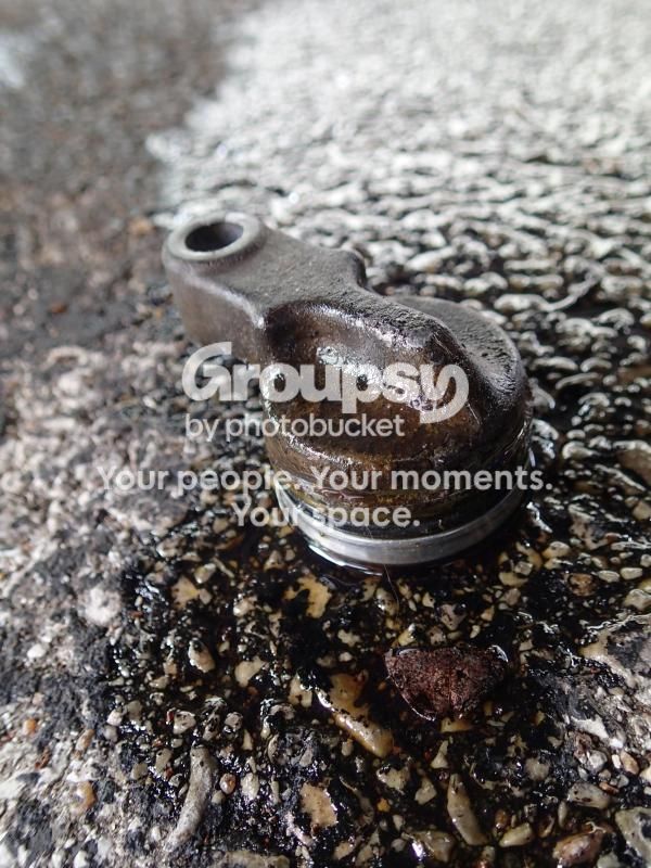

Then find this plug on the right side of the output shaft. Unscrew the bolt and pry it out. Gear oil will come out and if you're me it will run along the skid plate and drip on your head, making you smell bad and face you with a future 3 shampoo shower.

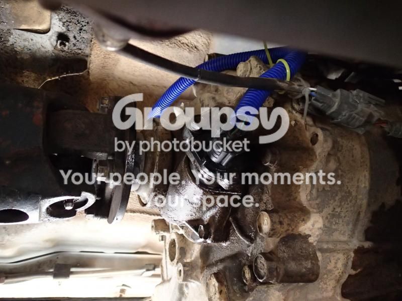

And replace with the sensor. It's the electronic and not the cable driven one with the shorter shaft than the cable drive version and it has 3 wires. This particular one came out of a 96 non-abs Toyota Tacoma. Several years had them, this one fit just right gear and all.
P6052661_zps9c05ad21.jpg~original
route the goofy blue wire holder out of the way (zip tied to the same holder as the o2 sensor but otherwise not finished in this pic)
