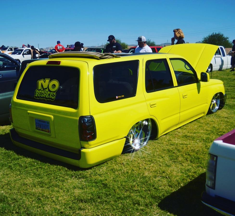

My 4runner is a 2 wheel drive. Can I put the same sensor your talking about in the rear of my transmission?
